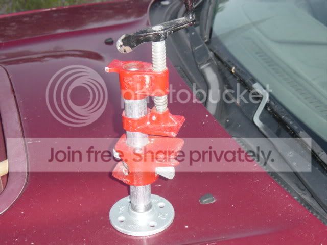

here is a simple and easy and very effective knife vise. i have to give credit to swede2207 for showing me this and giving me the 1/2" one i have.
Parts List:
1/2" or 3/4" Pipe Clamp from Harbor Freight - about $3-$4
6" galvanized nipple of the same size as the pipe clamp - $2
galvanized flange of same size as pipe clamp - $2
scrap leather or micarta for the jaws - $0-$2 (i used 1/8" micarta)

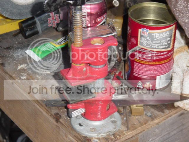

just screw everything together and apply the leather or micarta to the jaws so that it doesnt scratch the blade. on mine i sanded down the corners and edges and face to make it smoother and IMO softer. use epoxy to glue them to the jaws. i also sanded off the paint from the pipe clamp jaws to let the epoxy stick better. heres a few pics so you know how it looks. the first one is my 1/2" vise and the second one is the 3/4" vise that wasnt finished when i took the pics.
if you have any questions about it just let me know. as you can see it can be made for $10 or less.
