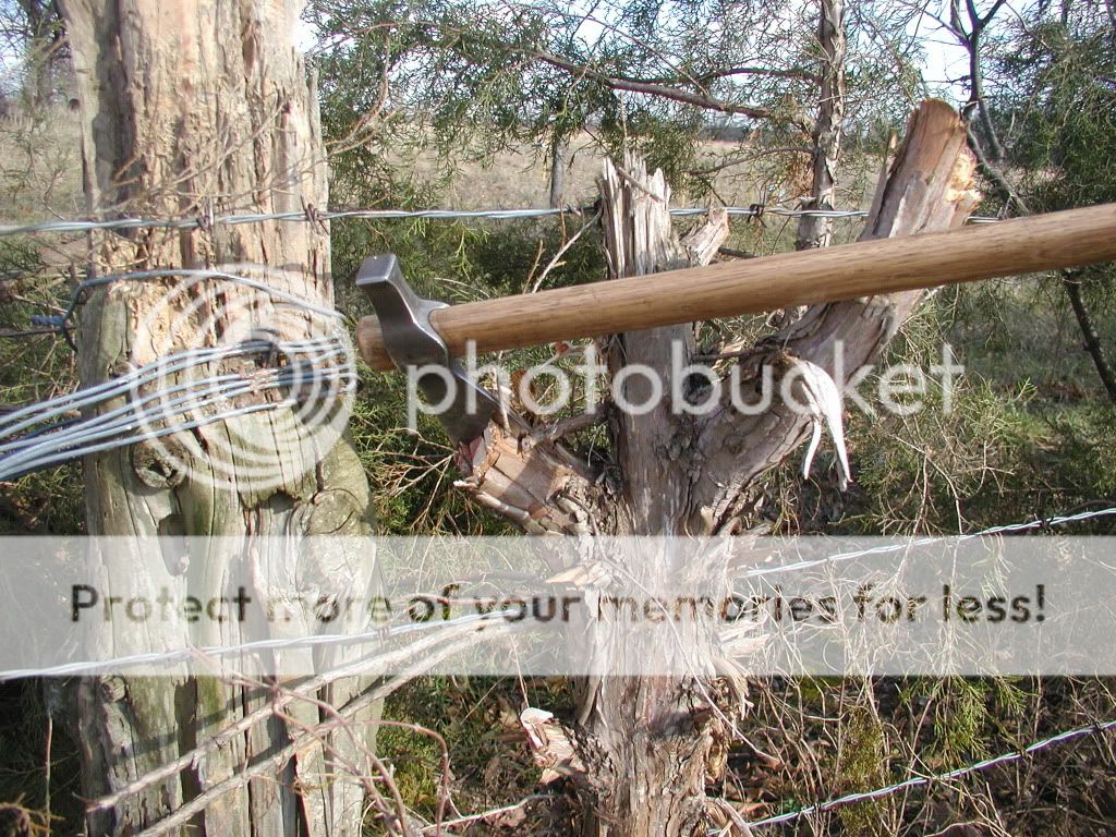

The tomahawk used was the very popular Cold Steel Trail Hawk.
It has already been established in Khan’s thread that the Trail Hawk will outchop the BK-9. My own testing confirms this. But it must be noted that a knife may be more effective in the hands of one unskilled in the use of a hawk. It is easier to miss with the narrow cutting edge of the hawk than the long cutting edge of the knife. Regarding pure chopping ability, though, advantage must go to the hawk.

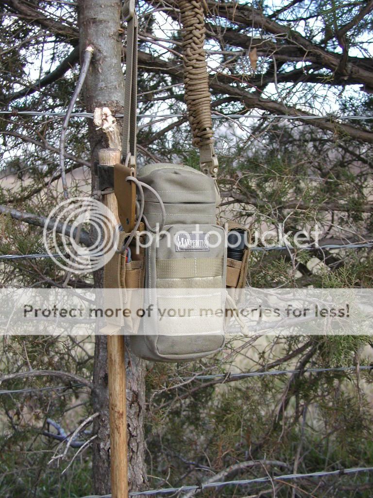

Regarding my choice, I have found myself choosing the Trail Hawk lately. It chops a bit better. It gives me a hammer. In my system, it is easier to carry. Just a loop of paracord, and it rides nicely on the strap of my Goody Bag.
