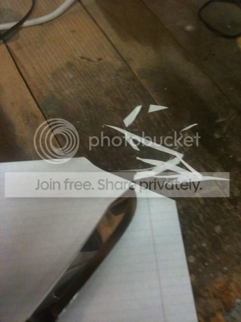

So I've been sharpening knives on and off for a while now and today was the first time someone handed me something that wasn't a santoku, french chef's, pocket knife or similar type of knife. It tapered very steeply towards the tip and my hand ended up in a very uncomfortable position when getting there. It looked something like this:
Again I haven't had any experience sharpening something that drops so steeply so if anyone has any techniques to make sharpening more comfortable, I'd be interested in hearing it.

I was actually trying to sharpen in sections towards the end but I was worried about uneven sharpening if I were to do so. As per what system I use, I use generic $5 stones and cheap grade sandpaper but it gets the job done as I can't afford anything better. I'm hoping to get my hands on some norton sandpaper but until then, this cheapo sandpaper from Ace Hardware will have to do. Also I was referring to sharpening the microbevel not the primary bevel (which yes was hollow ground). Also yes the knife is a Cutco. A friend of mine had an old client who wanted her knives sharpened on that day and she asked me if I could do it for her. I couldn't get the knife as sharp as I had hoped to as I only had about 30 minutes to try to bring up a burr, but I did get it at least sharp enough to actually cut some paper (there were so many nicks in that thing, it wasn't even funny).
