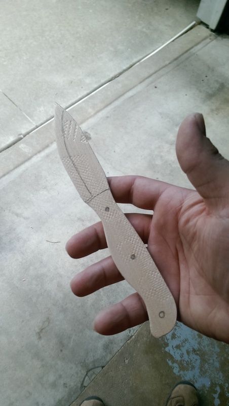

If you want to get a quick feel as to how your knife will feel in hand, I do the same as Elgin and make a wood copy of it.
I choose to use the larger paint stirrers from Home Depot. They tend to work Very easily, are right around 1/4" thick, and smooth out nicely with some 400 grit sand paper (use 60 or 80 and some files to shape).

Ok. So I finally had some free time to go to the garage and cut out my pattern from a paint stick. I am really happy with how it fits the hand so I think this design is a go for me. Here are a couple pics.
Sent from my SM-G920V using Tapatalk
Thanks guys! Not really sure if I am liking the look of the dip I'm the back. Looks funny but is comfy in hand so I guess that is more important than looks.
