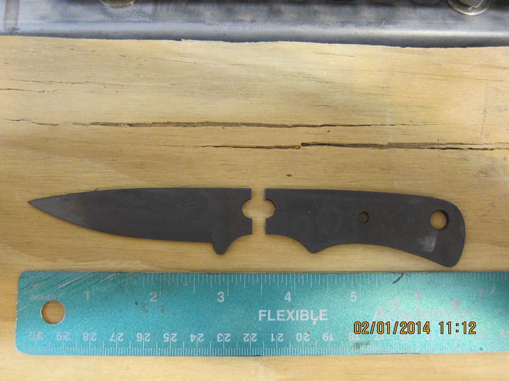

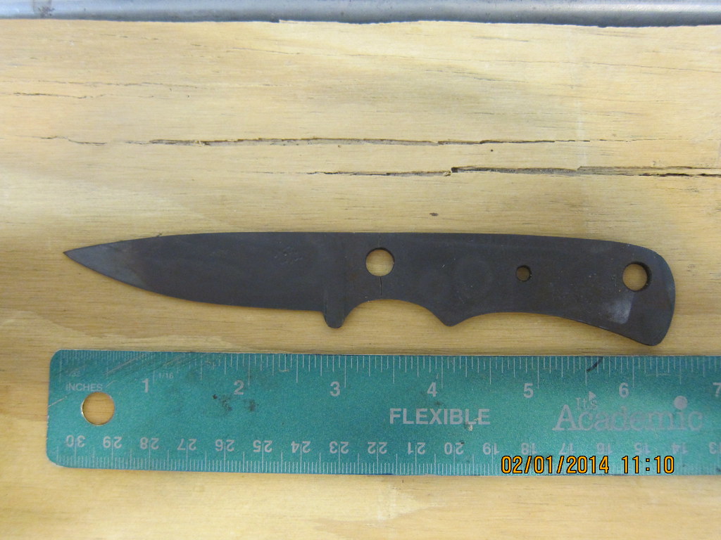

Can anybody make something useful out of the piece(s) pictured below? If so, I can stick it/them in an envelope and mail them to you. Postage is on me.
It is already heat treated (Texas Knifemakers Supply), but does not have a cutting edge. .093" A2, if I recall.
First come, first served.
Do you have a welder?
If so v it out and weld it, you'll need to preheat it and keep the blade section in the water, but if you want to have a great user for yourself, it'll turn out great.
No, Rock. I don't have a welder. Maybe you or somebody else out there would like to take it and fix it.
Thanks for the suggestion, though.
I can do something with it. I'll pay the postage as cross border is more expensive. I'll PM you my address.

Me thinks I need to pay closer attention to hole placement! Bummer that happened to you. Cool to see you make lemonade from lemons though.
