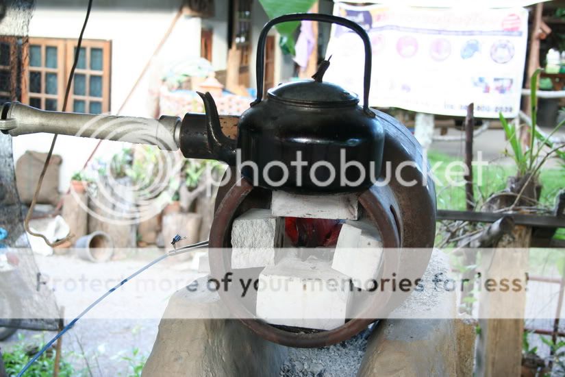

I forge and heat in my gas forge, also something for coffee :p:D
