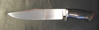

I recently received the fighter pictured below from Jason Knight, one of ten in his Founders Bowie series. I asked Jason to put a single guard on mine rather than the double hilt designed for the series, and he kindly obliged. The reason was so that I could test the piece as a general camp knife.
Ordinarily, I would never think to use a fighter as a camp knife, as fighters are typically lightweight and built for nimble, slashing speed rather than being stout and durable and built for power chopping and general utility work. But through the collaborative efforts of Jason and Joe Paranee, a devout student of fighting knives and compatriot to some of the world's top makers of fighting bowies, this knife incorporates extreme geometry designed to enhance both agility and striking impact. I wanted to experience that for myself, and I'm delighted to say that now I have. In short, it works.

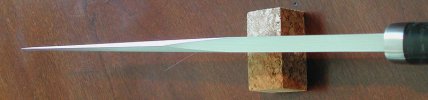

The 10" W2 blade is .350" thick at the ricasso, tapering to .32" at the start of the swedge grinds and then tapers at an extremely acute rate to an ice-pick point. (See photo of spine below).
The seminal idea behind this acute geometry is to achieve a fighter with plenty of heft to get the striking momentum of a freight train and still have a stiletto point that will dance under control like a Ferrari. The radical distal taper on this knife achieves that by keeping the weight back near the handle so it doesn't generate too much momentum in the forward part of the blade. The effect is remarkably successful in Jason's design, and I've not experienced anything else quite like it--seems I could just as quickly and gracefully stab a pickle from a jar or chop through a fence post with ease. Once I handled the knife, I was itching to try it.

I did a little work with the Ontario and the Busse to refresh myself with their characteristics, which always impress me. Both are a joy to use. Then I picked up the Knight. As I began taking easy swings into the aspen, I was immediately impressed. The blade is almost 2" wide even out at the start of the clip, with a flat primary grind that is nicely acute down to almost a zero edge with just a micro bevel--a very high-efficiency cutting grind. With 1/3 inch of spine thickness behind it, the edge sinks extremely deep with very little effort. The sweet spot is not as far out along the blade as on either the Busse or the machete, as you can plainly see by the marks on the three blades in the photo below.
But the depth of bite from the Knight was at least the equal of the other two, and my impression was that it was not as easily deflected from its course at impact as either of the two longer, thinner blades. You can see a little of this in the angles of the three knives as they sit where they stopped after impact in the photo below.
None of these in the photo were swung with full-house power--just nice, controlled strokes as consistent as I could make them. Also, the thick upper blade on the Knight tended to spread the sides of deep cuts more than the other blades did, which seemed to reduce binding.
I'm frankly amazed that a shorter, thicker blade can keep up with these two extreme choppers at all, much less push them to their limit of efficiency and comfort. I felt very little vibration from the handle of the Knight--much less than I expected. It was very comfortable even at high impact, due I think to the damping effect of the thick steel near the handle on both sides of the guard, as well as the masterful contouring Jason sculpts into his grips. I would have thought the wood more likely to transmit vibration than the Resiprene (hard rubber) of the Busse or the molded polymer handle on the machete. But it was not an issue, and the way the smooth grip of the big Knight rocked back and forth in hand was truly a delight to experience.
