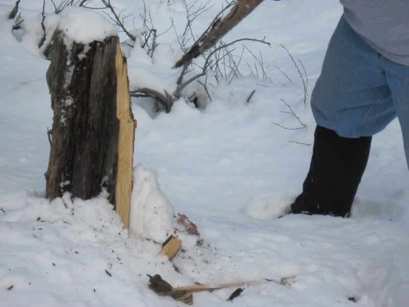

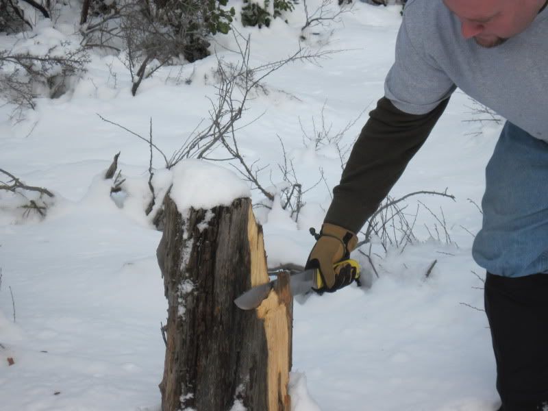

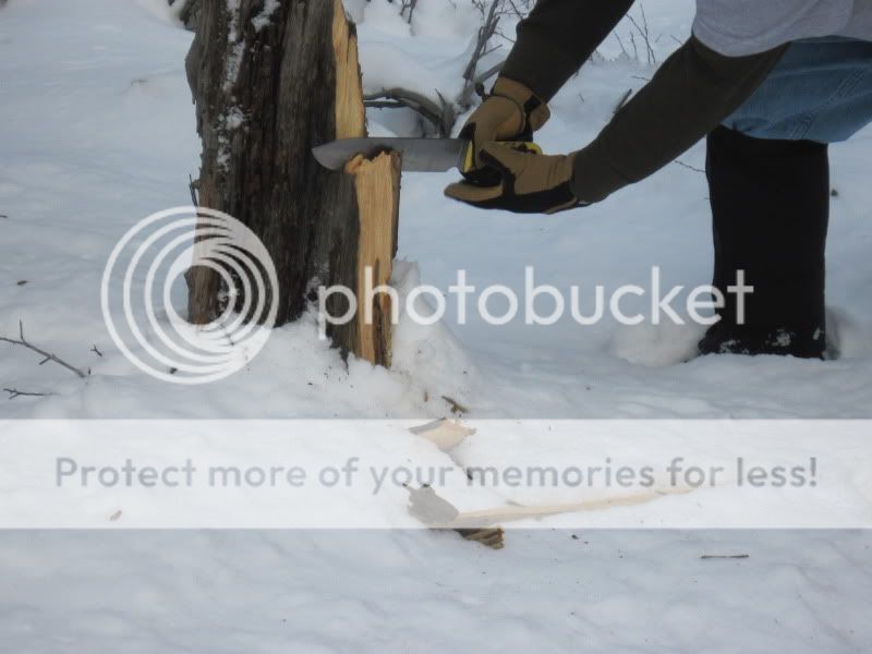

I batoned a CS 18" barong machete lengthwise through an entire 9ft. section of tree trunk from a blown-down maple. Batoning isn't exactly rocket science--you just have to be patient and keep the limits of the tool you're using in mind to make sure you don't strain it beyond what it can repeatedly handle. Keep the blade level and work with the wood rather than against it and you're usually fine. I have yet to have a knife take any damage from being batoned, but I've been careful and always respected the tool.
Never once had a knife break due to battoning. I've battoned .06 inch Tramontinas through just about everything, .09 inch Moras... hollow grinds, convex grinds, flat grinds, scandi grinds... I try to stay away from using hollow grinds for impact if I can, but... alot of it is being practical about your tool and avoiding overly hard and brittle stainless steels for your tools. It amazes me that people get so heavily invested in high priced high hardness stainless steels and then whine when they fracture.
It also amazes me how people can be so blind as to their using technique and then go and blame the tool for their own actions. If you put straight downward pressure on your blade, and avoid diagonally or perpendicularly impacting the spine of your blade, you shouldn't have a problem.
Avoid knots, make the most out of existing splits and grain patterns, and learn the little nuances of where to batton, how to twist the handle to pry the split open, etc. It's not a hard technique to learn but some common sense and practical application is involved.
