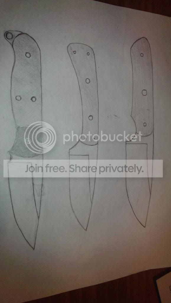

Here's how to get better. Draw a simple pattern. Post it here for us to look at and critique. Make it 7-8" long and fit on 1" wide stock. It could be 1.25" stock, but since you're using hand tools, might as well not kill yourself. Once you get a nice simple hunter pattern or similar drawn, buy enough steel to make 6 of them. Buy enough micarta and pins to make six sets of handles. Make one whole knife. Post it here. Get feedback. Rinse and repeat.

I'm actually drawing up designs in class right now! But once I get down I'll throw them up here. Thanks for the help.

I'm located in San Luis Obispo. And that would be fun to check out. But here are some ideas I drew up today. They are all about 8" long.
