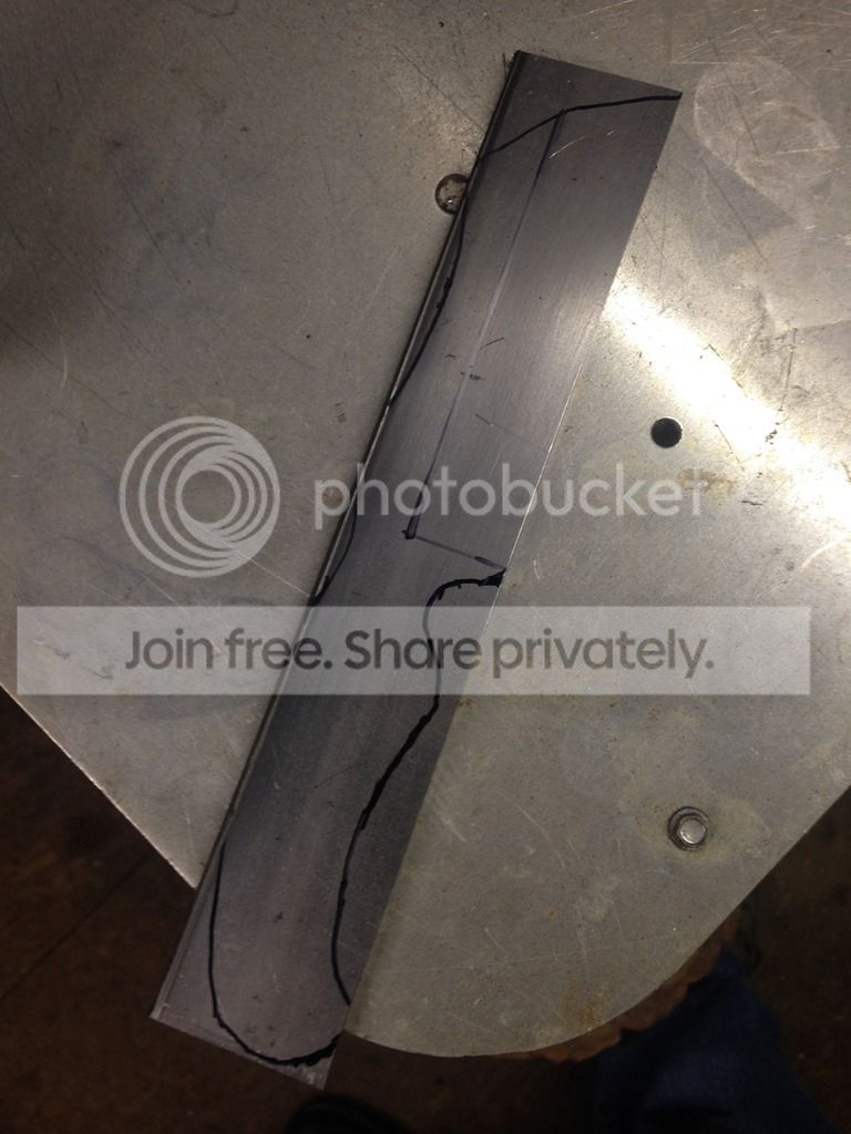

I don't have an image of it ground, but I actually have it profiled and one side of the blade flat ground, but a bearing went out on one of my platen wheels, and waiting on a replacement from OregonBladeMaker. I scaled my pattern a little too big so it's goes over the edge of the material so I ground it right to the line then scribed another line just inside of the edge and marked out the rest of the profile to get the exact shape I wanted and ground to that line. If I had a little more patience, would have waited till i went to work the next day I would have rescaled the pattern to the right side and saved a little work.

Ah ha.. :thumbup: Hard to tell from the image. I am going to try may hand at a chisel grind on a Karambit I have planned for my brother. Only problem I'm running into, I can't drill the 7/8" finger hole. My drill press won't handle a bit that large. I have one I started, but I'm not happy with it. I took it as large as I could on the drill press and ground the rest finger hole out, and it's not so good. So I told him I wasn't going to embellish it like I wanted to and he can still have it but I'm going to make him a nicer one. I'm just going to put some simple micarta handles and plain brass pins on this one. When I grind the next one I'll get a machine shop to drill the hole for me cause I promised him the knife for his birthday, but missed the mark, and want to make good on it. I did get good practice in on the first one grinding the curved edge though, and what a chore that was. after that, I'll wait till I have the equipment to do it myself before making knives like this with large holes in the design.
I drill a 1/2" hole then do the rest with a dremel. Takes a lil patients but it works. Ring knives are very useful to law enforcement and military because you can shoot and hold your knife at the same time. Among other reasons.
A bi-metal hole saw will do the job.
I'll have toe try that.
Yeah, tried that. My patience must not be that good.
