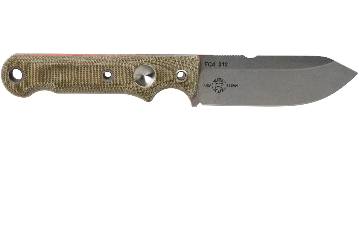

I've just found out about the knife laws in spain. They don't seem to like knives to have a blade over 11cm (measured from the end of the handle, so some knives get the short end of the stick even though their blades aren't that long).
With that in mind, I'm partial to buying the White River FC4 in CPM S35VN. How do you guys think that will hold up?

Pretty sure that will be fine.
Wipe it dry and the worst you should get is a few spots (maybe) that will polish off easy enough.
Or just buy some cheap stainless steel fixed blade while on vacation.
Won't matter if it gets a few stains, won't be too expensive, AND it's a souvenir that will have happy adventure memories attached to it. :)

Stabman is all over this. The knife will be fine, just wipe it off. I'm in salt water on the Washington coast all the time, zero worries.
