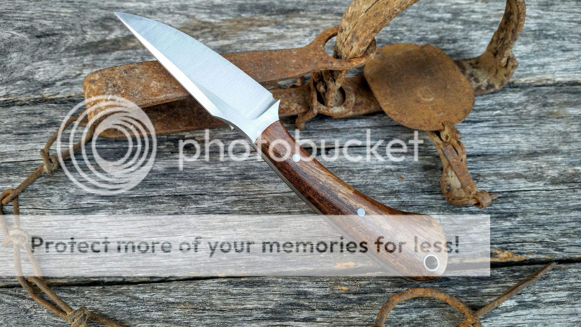

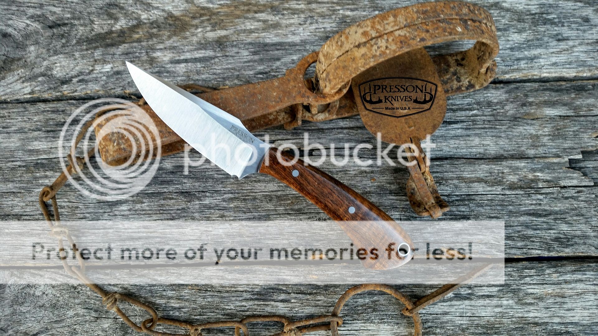

This is a modification of a caping knife I have made a lot of. I'm actually liking this profile better. Still needs pants and sharpened.
1084 steel
Stabilized Koa handle
Stainless pins and tube
I didn't take measurements on it but included a picture of it in hand for size reference. Koa is hard to photograph to show how nice it is.
Thanks for looking
JP
That looks very handy and is cleanly done...plus I like Koa :D
Can't really tell from pictures, but if I had a suggestion, it would be to bevel the front of the scales a bit more- IMHO that adds a nice touch on these little knives, and minimizes the end grain look
Bill
Thanks guys.
Billf I would agree with that looking back I think I could have thinned the handle down and tapered it more towards the front too. Thanks for the comment.
Nice, I especially like your grids. Bill offered good advice on beveling the front of scales.
Might want to start working towards tapering your tangs as that elevates a knife a level IMO.
Very nice finish on your Koa.
