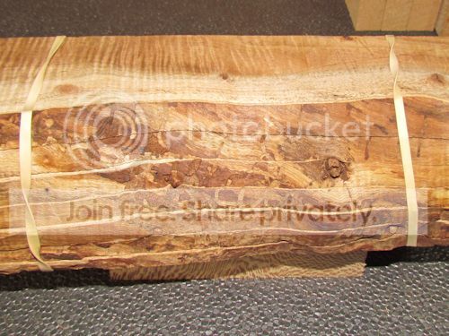

Here is what I meant. The 5th image shows how Koa should be cut if it has curly figure.

You don't always have much of an indicator on the outside of the log whether it will be curly before cutting. There are some hints sometimes but not always.

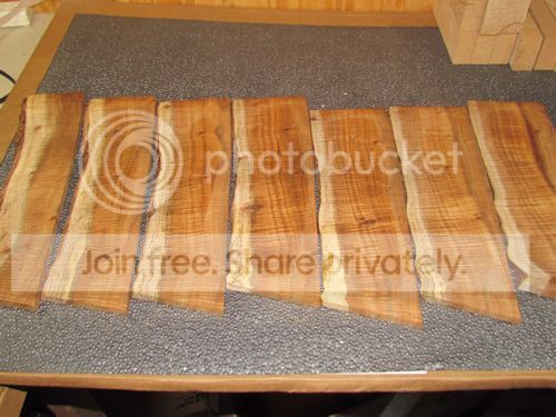

This is some curly Koa.

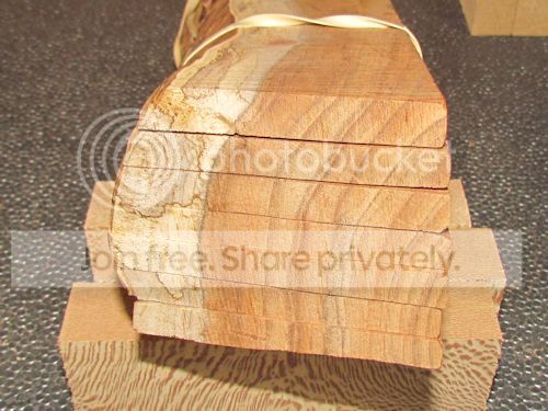

When you look at the ends the ones with vertical growth rings are the quartersawn pieces.
Looking at these slabs you can see that the figure gets better on the pieces that are exactly quartersawn.
Cross cut and end grain pieces are a lot weaker than properly cut pieces.
This makes them more prone to cracking and breaking.
