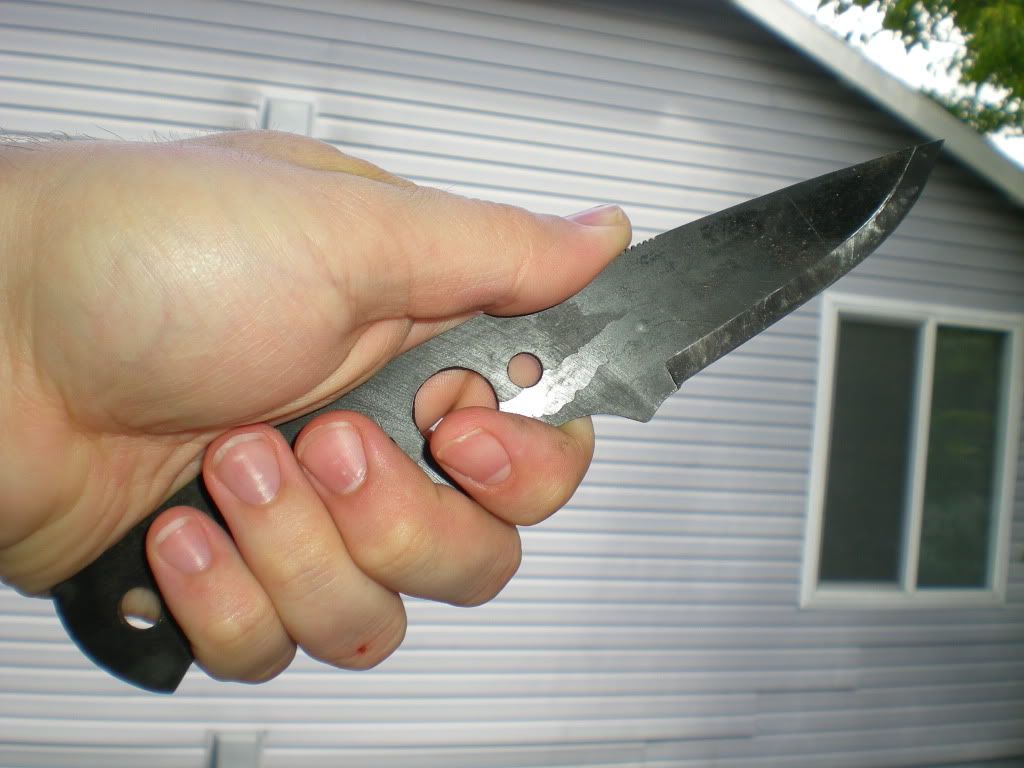

A while back Dan put out a post looking for some knife testers.
My pair showed up yesterday. I have no idea what the steel is, or what it's going to be when they go into production.
I got ugly, as quenched blades with a decent functional edge. 1 scandi, and the other what I would consider a high flat saber grind.
Out of the box, the points are needle sharp and quick flicking cuts shredded the cardboard - all the way through. push and pull cuts in newsprint were also easy.
The handle has plenty of holes of differing sizes that would be useful as lashing points or for attaching permanent scales.
The notched cut into the spine for thumb index are a bit too close together IMHO - they're sharp enough to use as a wood or plastic file/saw. OTOH, they also worked great for shaving a magnesium bar for fire starting and the spine is squared perfectly for the flint rod - threw great sparks.
The edges all the way around are "sharp", and the butt of the blade dug into the meat at the back of my hand, so first thing to do was to cover the handles. One got about 14' of paracord wrapped around it (ugly, but it works), the other got scales made of cardboard wrapped in electrical tape. (again, ugly - but effective)

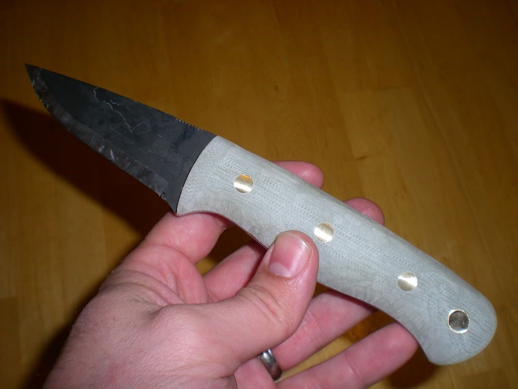

I received my test blade as well, with a scandi grind. If I remember correctly they are 1095. It arrived similar to 1066vik's blades, with the scale on them but a nicely ground blade and surprisingly sharp point. The blade is nice and light, something I definitely look for in a BOB knife or neck knife. I have small hands so the handle is a little big for me without scales but functional just the same. I was thinking about doing a paracord wrap on the handle but since 1066vik put one on his I will let him review what he thinks of the knife after wrapping. I will most likely put on some G11 for scales. I know Dan is looking at these blades as great BOB blades and to be used, hence the scale on the blade. I am totally fine with the scale on there and like the look of it, more rustic I guess, and makes me not too worried about getting it dirty :D

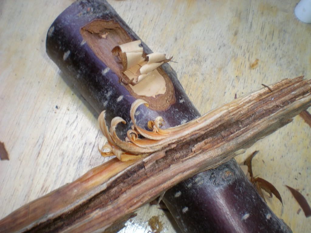

So, my review of the blade without scales. Well, the blade arrived with a workable edge but wasn't quite as sharp as I like but since it's a scandi a few minutes on a stone sharpened her right up. For the preliminary pictures, here's one of the knife in my hand and how it performed cutting curls in some fatwood and some seasoned cherry:

I have mine gluing up with some G11 right now, it will get kydex pants, possibly a set of leather if she behaves... ;) As one would expect with a thin knife, using it without paracord or some sort of handle attached it eventually does create some hotspots. Personally I don't mind paying less for a knife so that I can handle it myself or use it without if its comfortable - that's one of the reasons I bought an Izula. I'll post pics and do some more playing with this blade once the scales are finished.
Nice job on the handle. Looks comfy and I'd guess that it makes that knife so much more useable. Cool blade shape. Kinda like his Bushcrafter but much shorter. The handle size and shape look well thought out too.
This is a really comfy knife. As I mentioned I have medium sized hands and without scales it was a little big for me but with scales it is very comfortable. One thing I forgot to mention is that before I put on the scales I tried it out with some winter gloves and some work gloves and the oversized (for me) handle worked out great with both pairs of gloves. The blade gripped will into the leather without being uncomfortable at all.
So far I am really liking this knife. One thing is I would probably go for an extra 3/4" or so to the blade but so far that's the only thing I'd change... I'll try to finish the handle tonight, but most likely it won't be until tomorrow...
Oh, one more thing - this is some of the best jimping I've felt on a knife before. Not so sharp it cuts your thumb up but sharp enough you can really get a fantastic grip. I was thinking at first that I would probably like almost twice the length of jimping but I changed my mind - this is perfect!

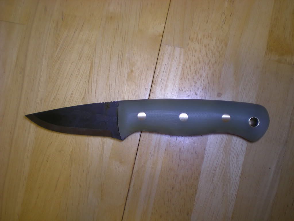

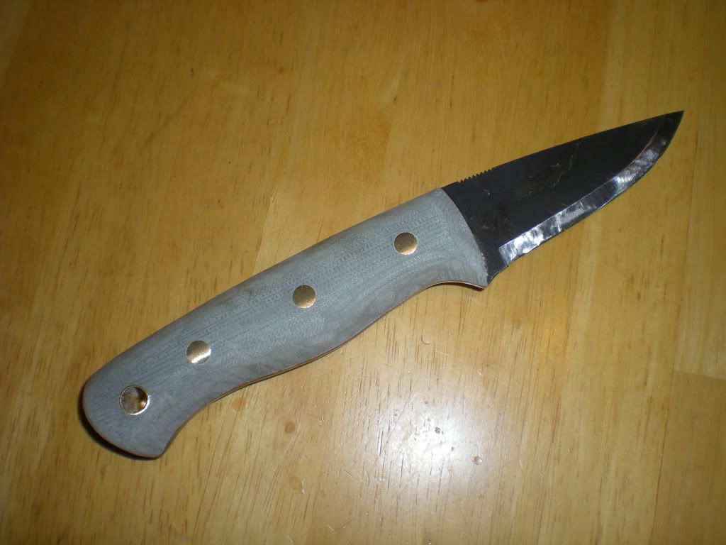

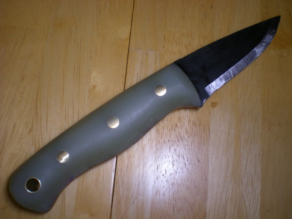

Scales are done. This is my first time using G11, I like how it grinds but I don't like how see-through it is when it's thin - you can see through to the steel underneath it... Oh well, it's comfortable and this knife wasn't made to be pretty! I haven't had a chance to play around with her more today but I'll start her kydex pants tonight...
Now that the scales are on I do not feel that the handle is oversized at all, it really fits great in my hand whether its gloved or bare. For a bushy PSK this is the correct size blade and grind. If this was supposed to be more of an all-around knife I would prefer 3/4" more blade and more of a belly for skinning but as this knife is to be a lightweight BOB/PSK to do many tasks I am really enjoying it.
Anyway, finished knife:
I love it. I have a bunch of G-11. Maybe I'll use a white liner!:cool:
