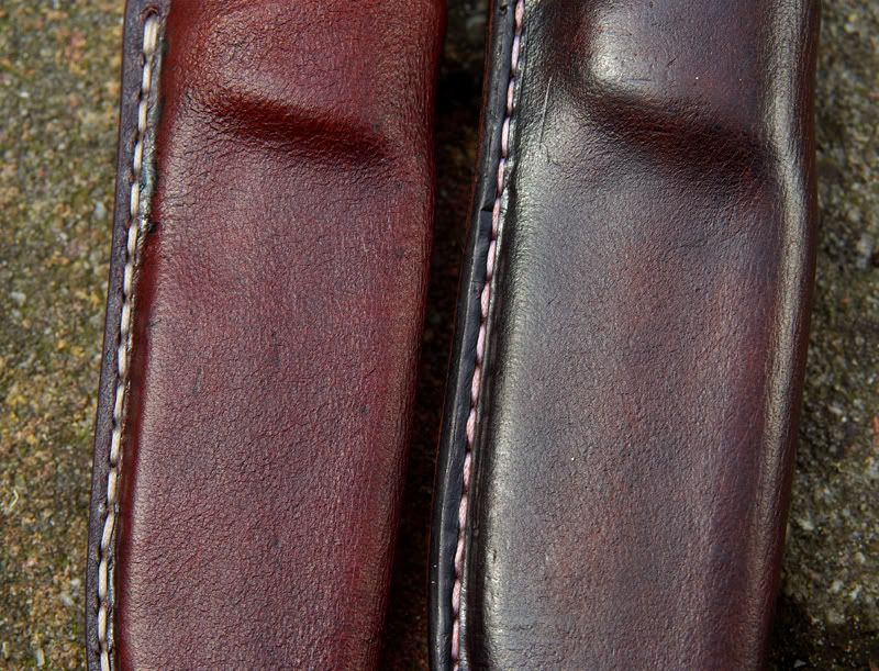

Maybe it's shrunk so tight that it will stay put?
No.

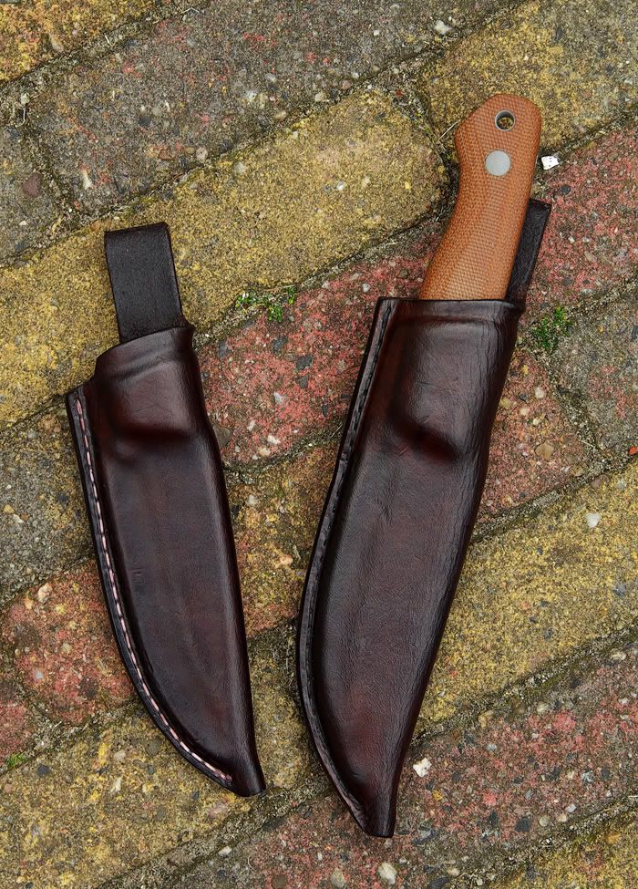

Without coming up with a tutorial: It's a combination of wetmolding, and shrinkage to fit. Applied heat during the process, and the finish also have a role in that. But if I had to name it, I'd call it molded to fit, not shrunk.
That goes for the halftanned.
The lappleather is another story. I haven't really cracked that yet. The sheath worked out fine, but there's a very very little space between the leather and the kydex. You can feel it when you push it in.

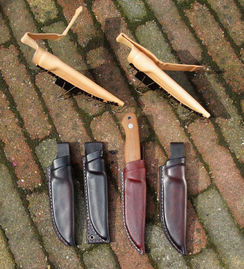

The one on the right is my favourite.

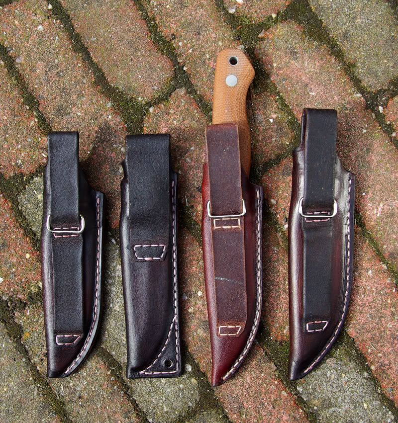

I won't use these rivets anymore until I get a decent rivetsetter.
The look is great, but it feels a bit 'plastic' compared to the halftanned..
This setup worked best after all.
