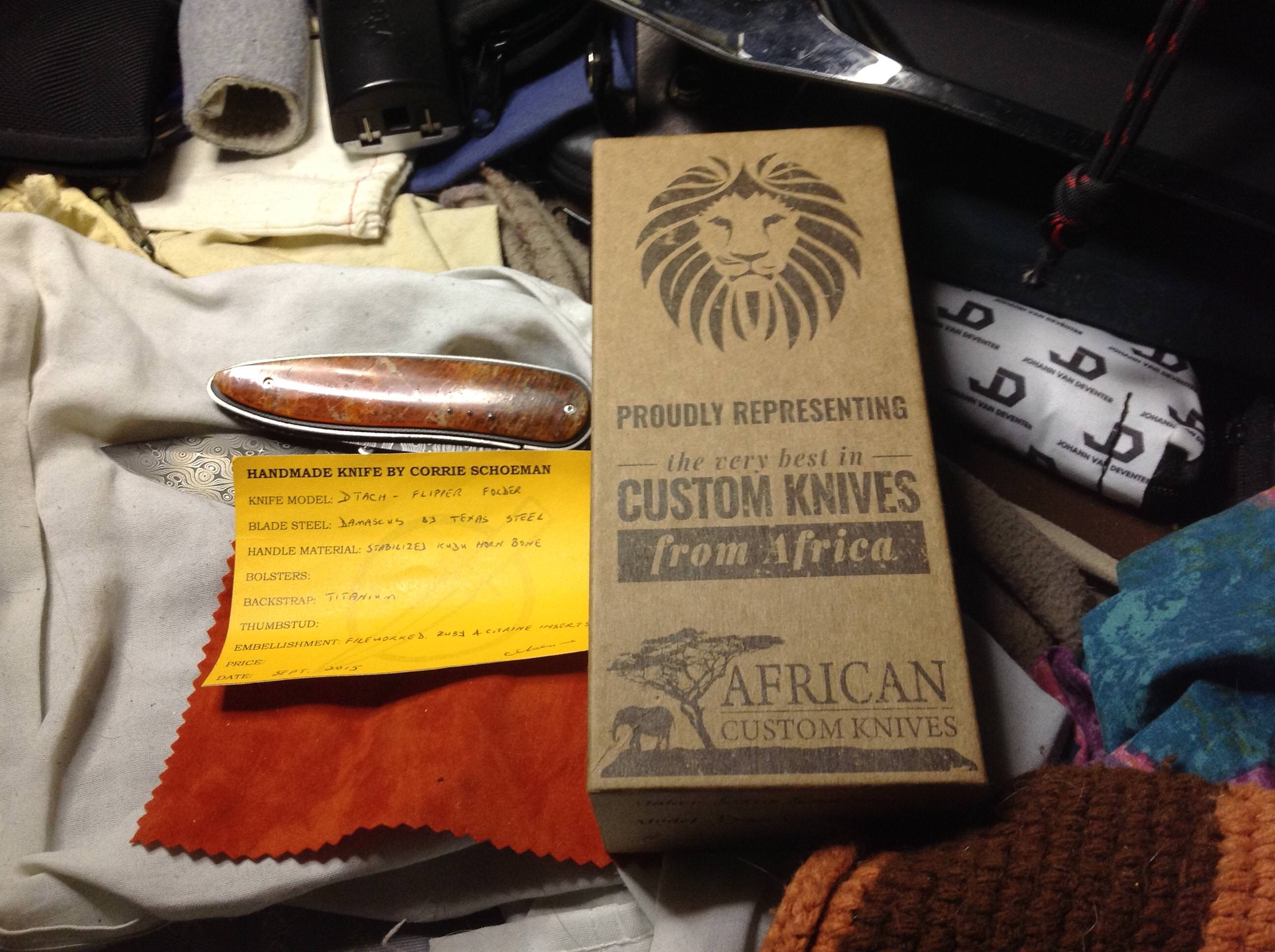

https://imgur.com/a/Z9lT8 Just acquired this Corrie Schoeman w Kudu Horn. Why or what is this supposed to be? Damaged, Cracking inside? What bothers me most is the areas where the white looks to be on the surface not buried inside.
Above is the album of 8 photos. Havent yet figured out how to post more than on bbcode link.
That looks nothing like any kudu horn I have ever seen.
