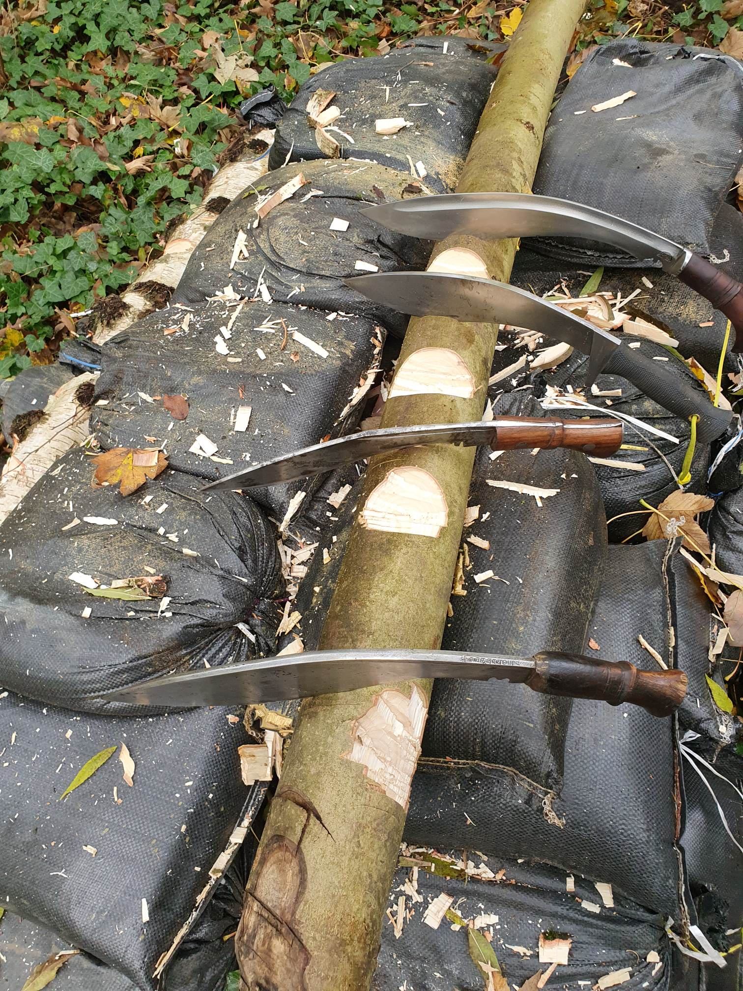

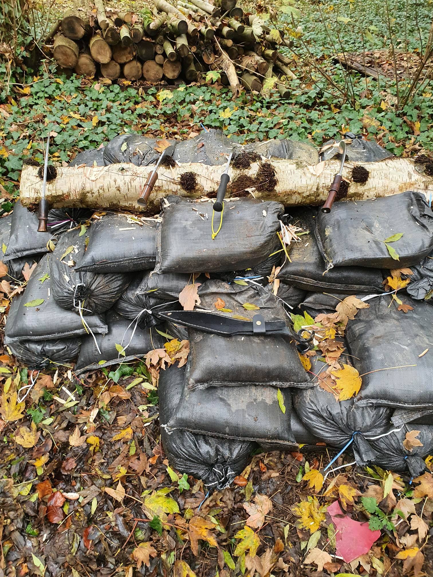

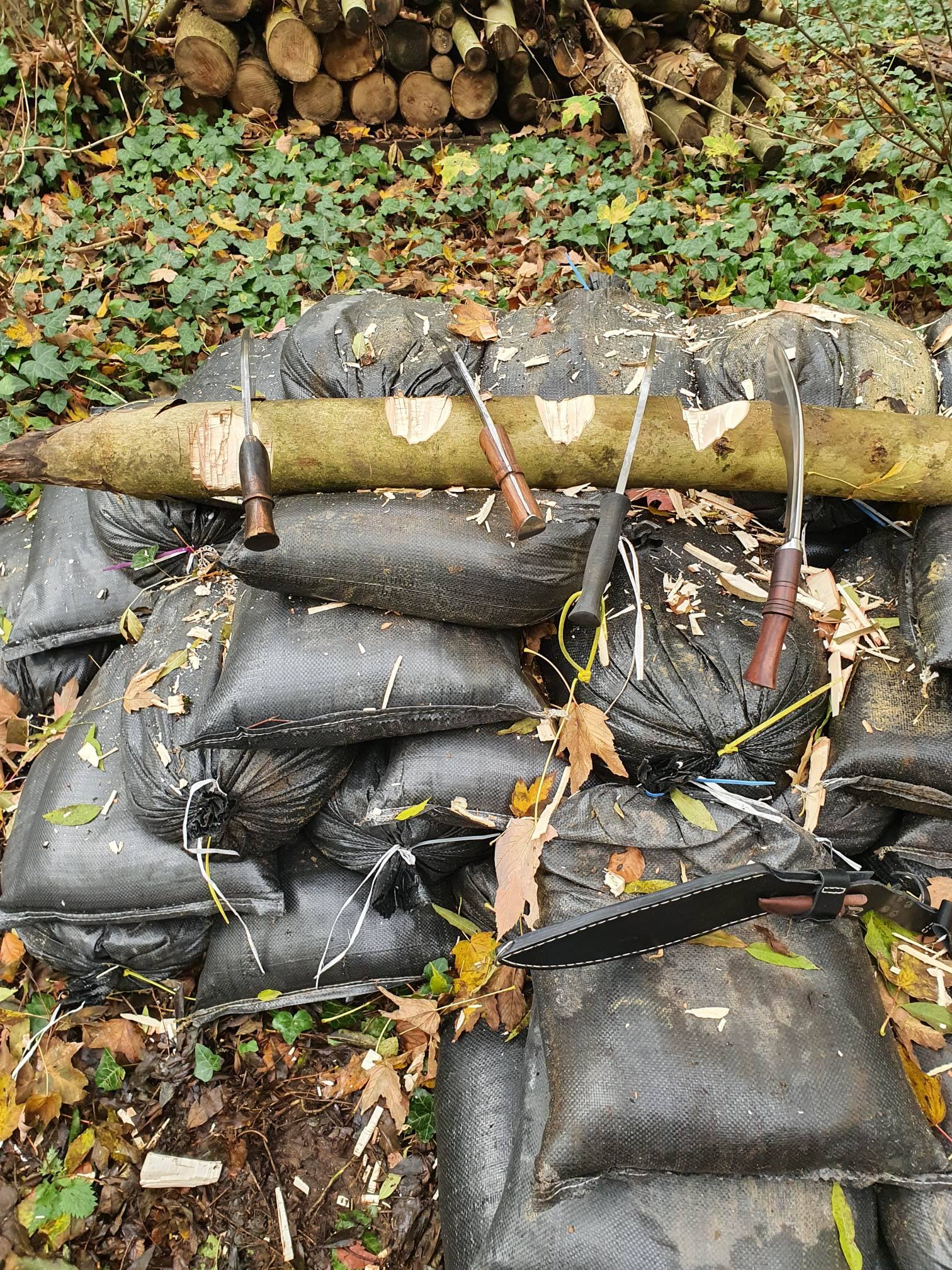

First of all I used all three to chop through a fresh 4 inches thick willow branch. The Nepalese took 36 chops, the Plus 26 and the LTC 21.

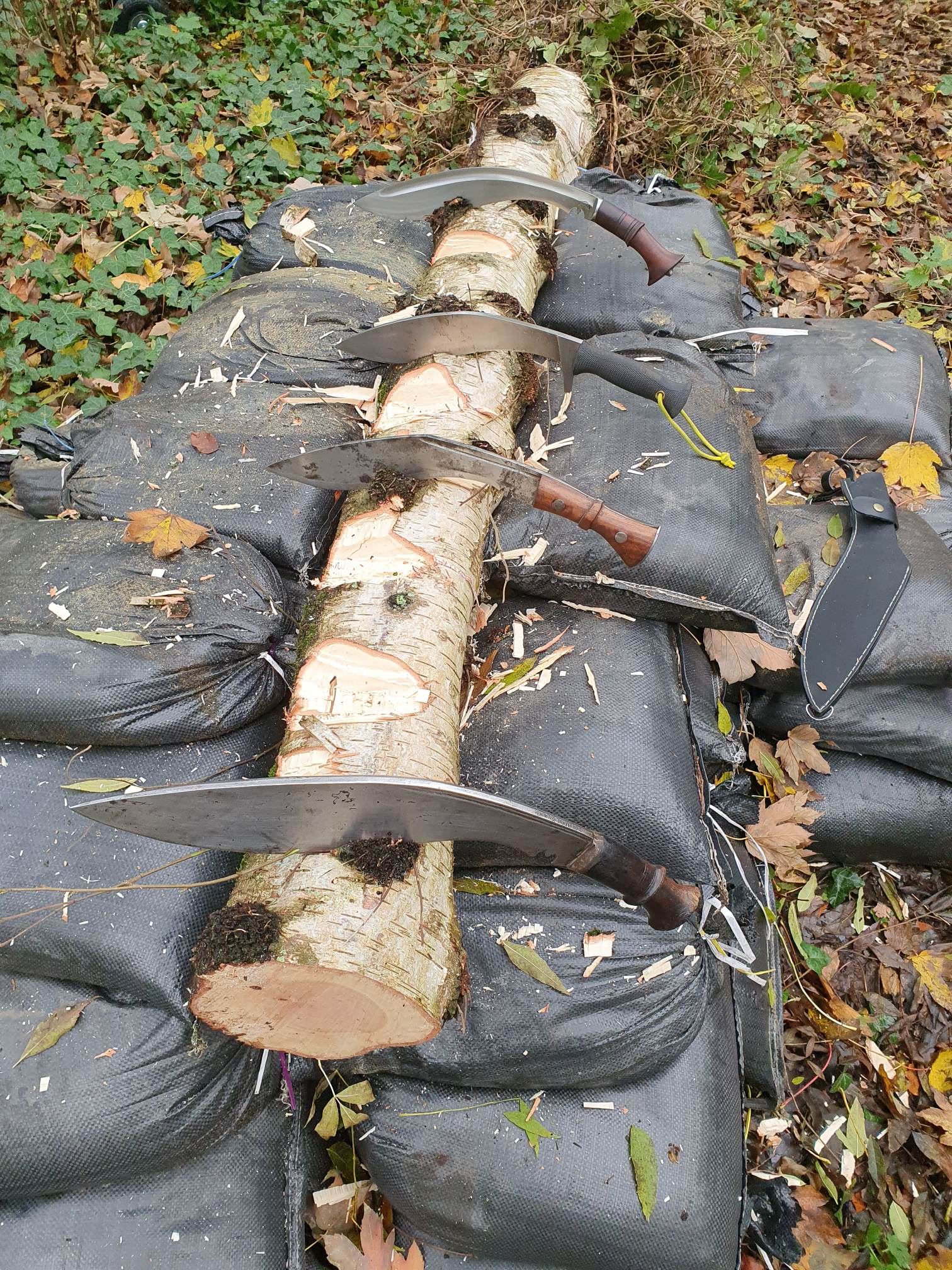

Then I took another branch and chopped ten times with each Kukri.
The LTC chopped deepest, I chopped a bit wider with the Plus but I think I removed about the same amount of wood. The Nepalese was the worst chopper.

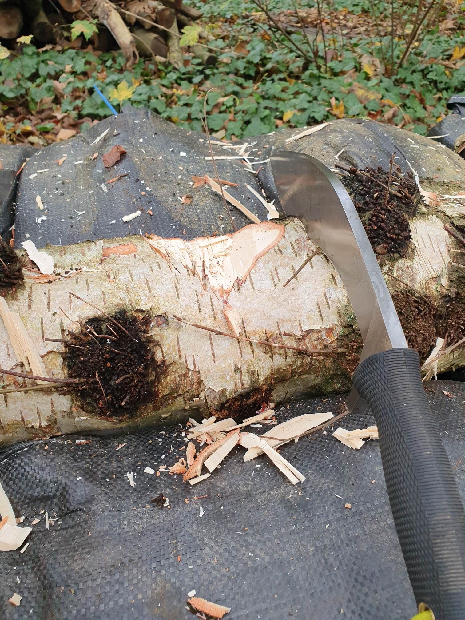

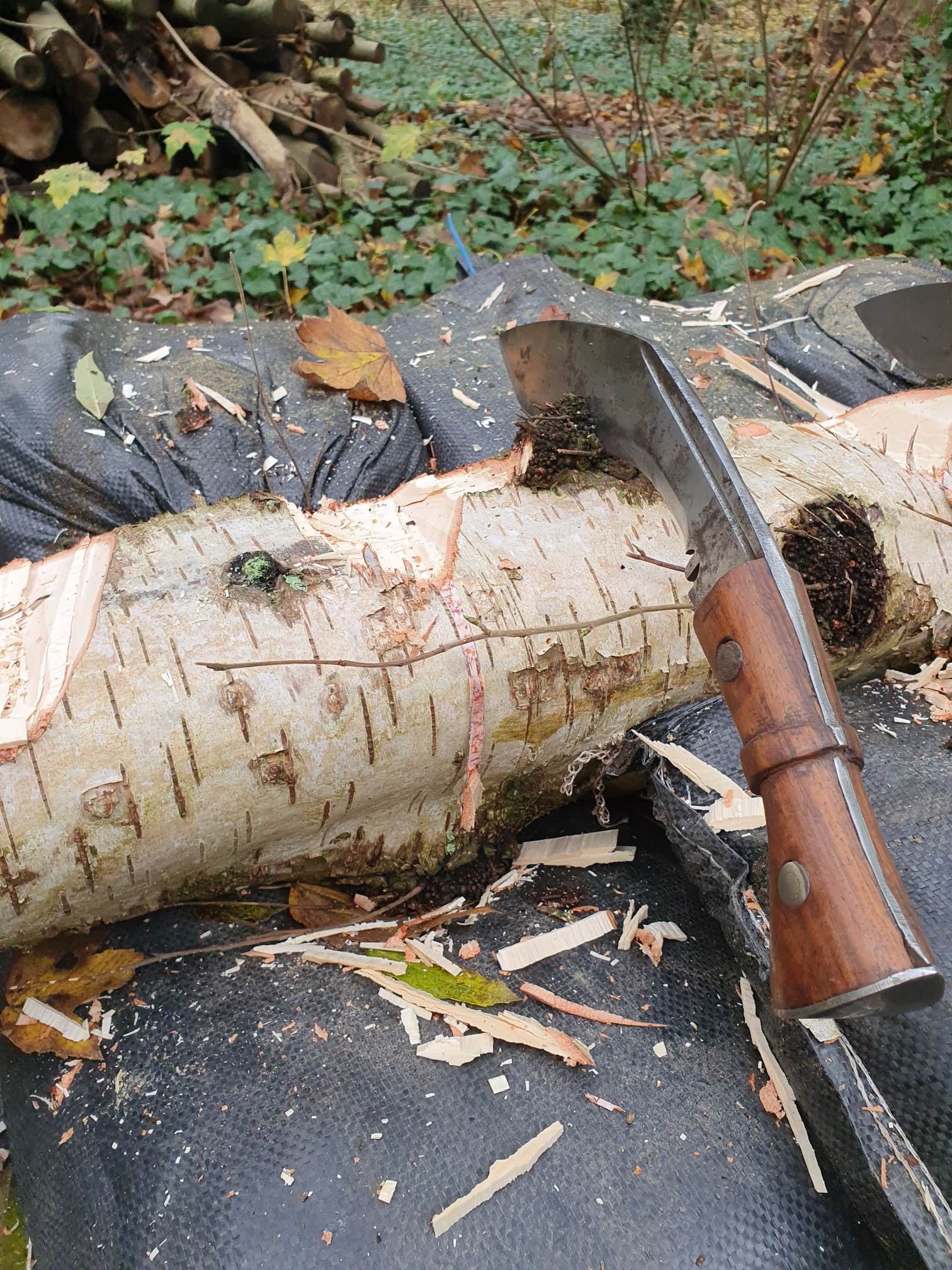

When chopping both wet and dry wood, the LTC chopped deeper but was also stuck almost every time. Pushing the handle down freed it without effort. I didn't have any problems with the other two kukris getting stuck in the wood.
Next I batoned some wood. The LTC is to thin, it didn't do well. The edge of the Nepalese is to thick, it didn't cut in the wood well, though the blade was thick enough to baton through if you take the time to get the blade in. The Plus did best, the blade cut immediately in the wood and went through it like through butter.
