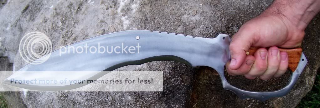

Kukri Fighter Custom Piece:
Hi guys. Finished this custom piece for a customer this week. I’ll be adding it to the web site in a few days. Hope you like it.

Steel = 5160
Total Length = 18 ¾ ”
Blade Length = 13 ¾ “
Blade Width = 2 5/8 “ widest point
Blade Thickness = 1/4 “
Handle Length = 5 “
Handle Width = ¾ “
Handle: Teak Wood.
Weight = 2 lbs 8 oz
Black Leather Hand Stitched Sheath
Thanks guys. I'm pretty sure the guys was going to put it to use. He wanted it made out of 1/4 " steel.
I based this off of a customers specs. It’s not as shallow as you might think. It’s more of a 22 ½ degree angle. But I’m basing that just off sight. It could be off a little one way or the other. I tested it on a jug full of water and it sliced so cleanly. You didn’t feel a thing. But most important, my customer loves it.

Not an easy knife to grind. Are you saying the primary grind is 22 1/2 per side or is that the combined angle with each side being around 11 1/4 degrees?
Fred
Thank you.
The way I see it, if you do a straight line down the center of the spine all the way to the edge, each bevel right and left would be about 22 1/2 off the center line. It could probably be more, but it cut pretty darn good.

When I grind false edges using the bubble jig they can be as steep as what you ground on this blade and I agree they can be extremely sharp, the only drawback I see with this wide an angle is there is hardly any way to sharpen using what would be considered a common sharpening angle such as 12 degrees. I have found with the false edges it actually dulls the edge. The only way I have found to keep them at that same degree of sharp is to do the same primary grind on them.
The false edge on this blade is ground at a 20 degrees a side with no secondary grind it to say it is sharp would be an understatement.
