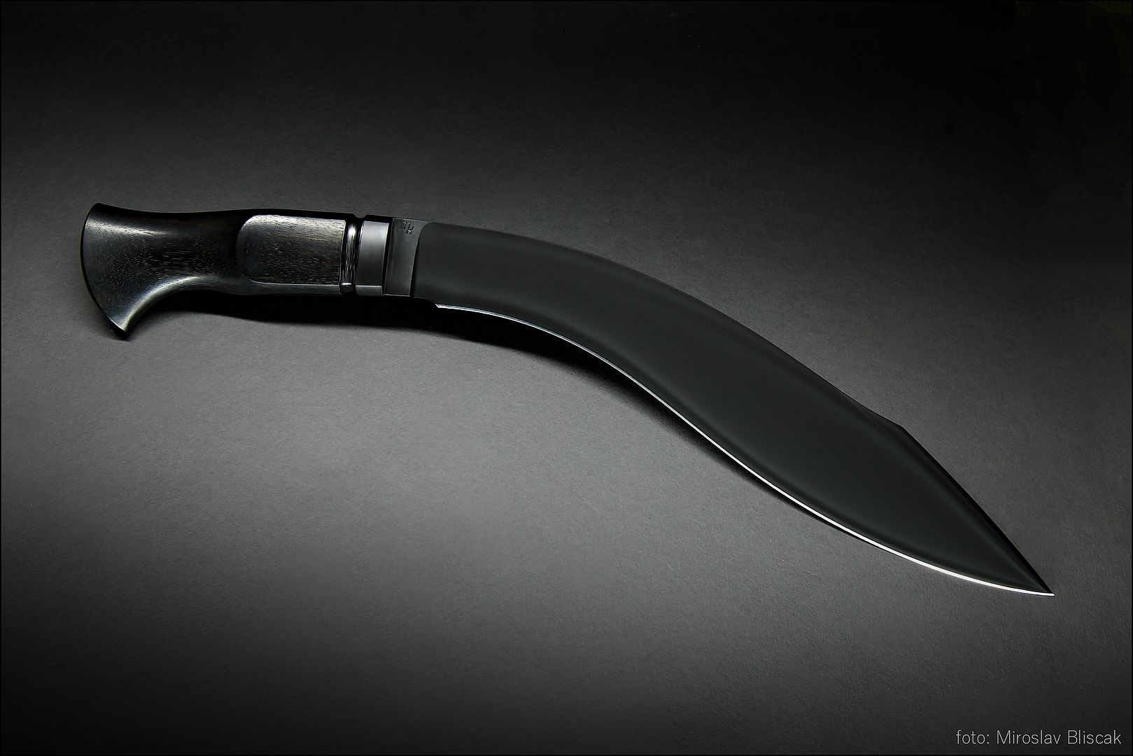

Hi everyone.
New Kukri from my workshop
A few basics about it follow.
_The blade itself is made from Tenasteel after DLC coating
_Blade is hardened to between 58-60Hrc.
_Handle is made from Ebony wood, Carbon and Ss guard in DLC
Blade is made from Tenasteel.
Blade is through hidden tang knife that is tightened by a nut from the pommel.
This is then hidden with a plug from carbon material.
Cow leather sheath with ostrich skine.
Here are the dimensions for knife.
Total lenght-410mm(16,141")
Blade lenght from ricaso-270mm(10,629")
Thickness-7mm(0,275")
Thank you all for looking.
