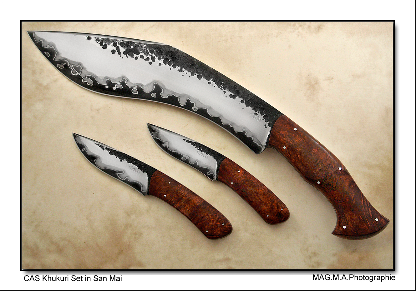

all the blades in the pics of this thread are really great I would like to be able to afford some of those -- BePrepared - the one with the Hammon can you tell me who makes that or is it one of a kind ?

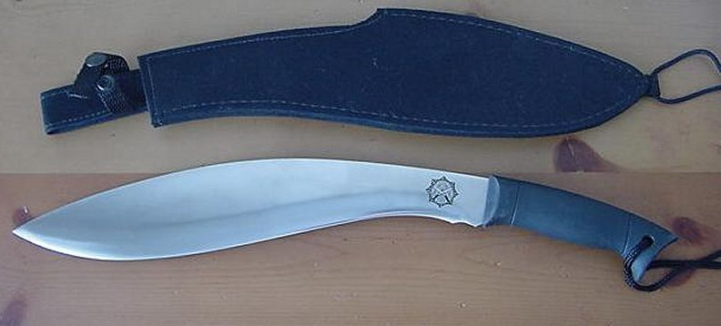

I bought the Ontario a few weeks ago, and i love it! Sheath isnt great but it works. an HI is def on my list but the Ontario is what i could afford at the time
Those are not khukuris they are khukuri like objects as we like to say. A true khuk is hand made and has a nice convex edge... IF you want a chopper, dont get something that is flat ground like the CS. my 15" sirupate by HI can out chop the CS and its smaller. MY HI is 3/8 inch thick too. Would you rather have something that is mass produced with a robot personality, or would you rather have something that is lively and hand made? Not to mention that with the traditionals you get a extra small knife and a sharpening steel.

I like the CS much better if you are worried about fighting with it. The full flat primary and v grind will be much more effective, IMO. A convex grind will work better on wood. The HI's are well made traditional khukuris, but they certainly aren't perfect either. I've had some with spotty heat treat, and I find the butt cap is a constant source of irritation while chopping. I also have problems with the horn handles splitting in my dry climate. But in all, they work fine, just be aware of what you are ordering.

The rubber handles on the Cold Steel version will tear the flesh from your hands. It is no fun to use for anything more then a few chops. Then again, you could use it with work gloves.

BFH44,
I'm not BP but I think that's a laminated blade not a hamon, by claudio-cas and it's a Custom.
Doug
Hello!
Like Doug said, it's a lamination line on one of Claudio and Ariel Sobral's Custom Kukris. Here is a set I was lucky to get from them earlier this year:
