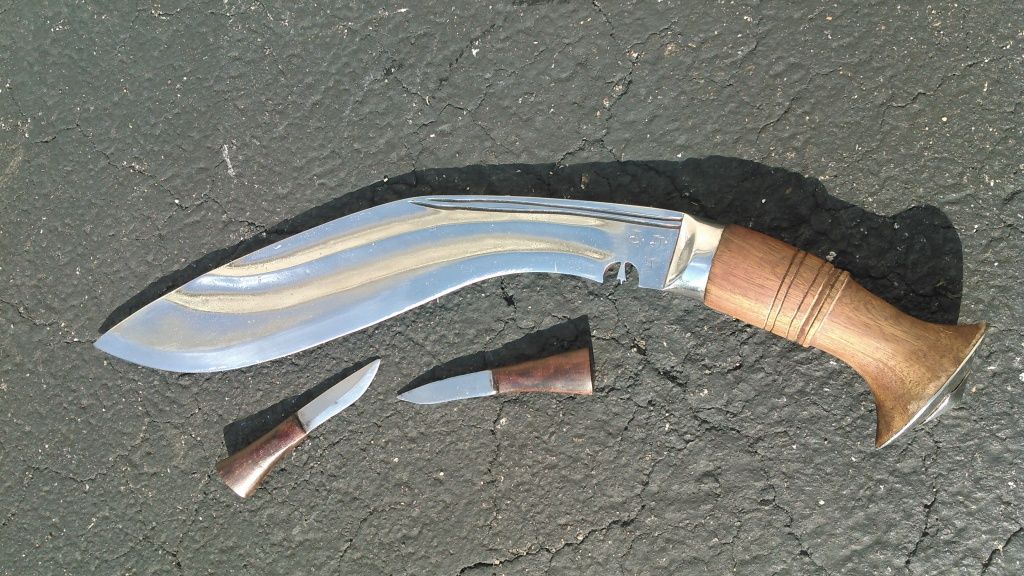

Sorry for the confusion, it's two styles of Dui Chirra that I'm talking about. One I call "Foxy Folly style," and the other "Tin Chirra style."
Here is mine, "Tin Chirra style" because it looks like it could have a third fuller, but really that part by the edge is flat and thick.
Compare to the one you linked to, "Foxy Folly style," scored by LaRueOBR556. Here's a similar pic from his unboxing.
And a link to that thread
http://www.bladeforums.com/forums/showthread.php/1350011-Proof-Yangdu-has-a-time-machine!!!
Those are both Dui Chirras by Thamar, but the placement of the fullers is quite different, which is why I started calling them by those two style distinctions.
As far as I know, the Foxy Folly is a specific model which was first requested/designed by a forum member. I read the thread one time. I wanna say his screen name was Fox-something, and the original name was Fox's Folly, but it kinda morphed over time. It only comes in one style: awesome, but it does come in different sizes. Largest I've seen was 18" but there's gotta be a bigger one, and the smallest are around 9". They're every bit as awesome as the big ones, but nearly 4 times as cute
Oh, that's my misunderstanding - no need to apologize :)
How does the FF compare to the "X" Chirra style?
Main thing is that it's lighter and has more belly, but the balance and feel are completely different. I'll refer to the "only one" thread for a side by side comparison in pics. That thick section of steel on my DC brings the weight farther out towards the tip and gives a more obtuse edge angle, which both aid in brute chopping ability. One inch from the tip of the DC, the spine is thicker than anywhere on my Foxy. The Thamar feels very tip-heavy, while the FF feels nimble and light by comparison. It still feels heavier and more tip-heavy than an ounce-per-inch KLVUK though.
Because it is light and the spine is thin, I'd always assumed my Foxy would not be a great chopper. That is until I compared the edge profile to my Keshars and Tamang. I found that both KLVUKs and the Tamang have relatively wide edges, which yield a very acute edge angle. The FF on the other hand, though thinner all around, has a narrower edge, resulting in a more obtuse angle. I had only been considering curvature, weight, length, and balance before, but after that experience with the Tamang, I believe the combination of attributes that the Foxy Folly possesses will outperform both KLVUK and Tamang, and offer similar attributes to the DC. However it will have reduced weight and hopefully be even more comfortable to use all day, due to its balance.
So basically, they're similar but very different. Both have advantages and disadvantages, just like any other khuks.
And keep in mind I'm only talking about a Dui Chirra here, because I personally haven't used a Yek or Tin Chirra, yet. I'd imagine the Yek would slightly outchop the Dui, and the Tin would be slightly more balanced/light in hand. All of them have that traditional multifullered look though.
It's important to remember that any khuk you get, whether KLVUK, M-43, Dui Chirra, or Foxy Folly, will not only preform the tasks you need done, but far exceed your original expectations.
