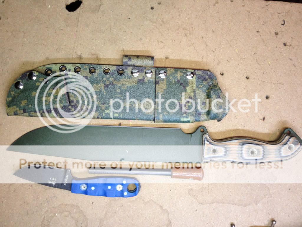

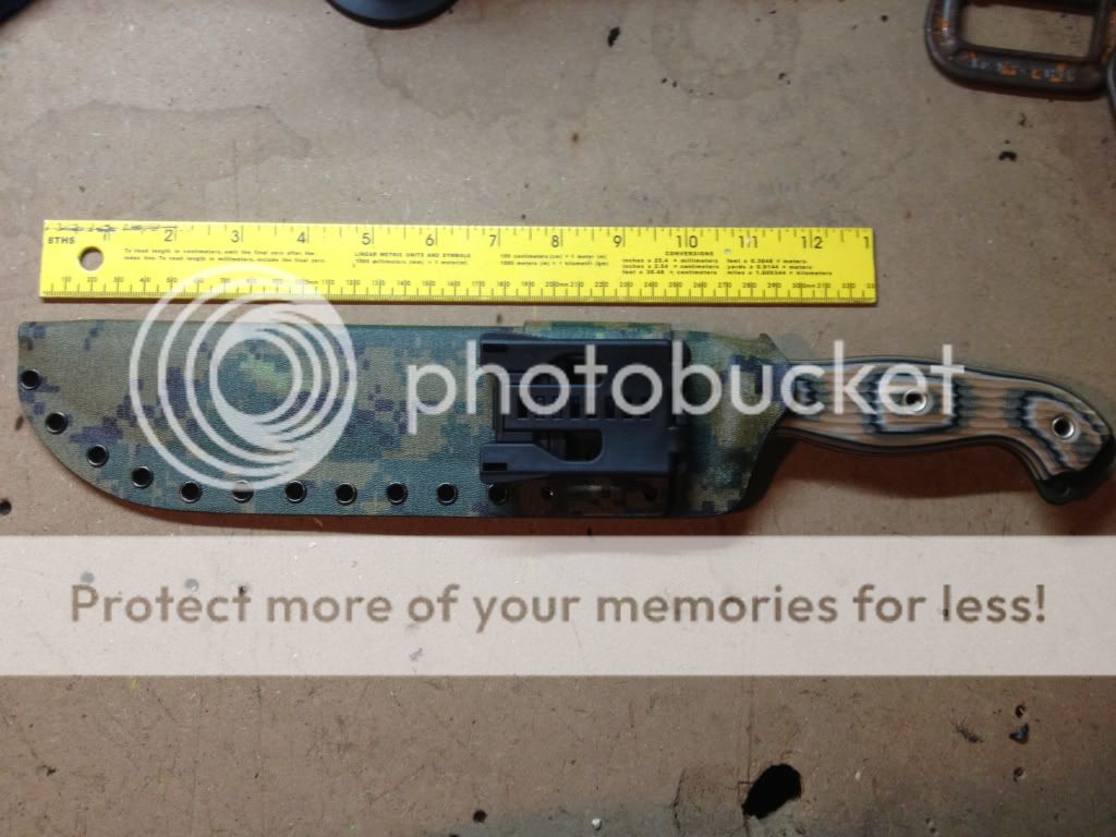

The pancake does allow for more mounting options easier. Also mounted on a pack it makes it a bit more secure I think. But you can use a fold over and make it just as secure if you make it right and allow for all the same mounting options. I mold a band around the sheath to allow for extra mollie locks to make it more secure on the pack or to mount a teclok in the middle of the sheath instead of only on the side with the rivits.
Here is an example of what I mean for the fold over with the wrap
The option are endless with either syle limited only by creativity. Here is drop loop for it also
Fold over = slimmer less lashing points
sandwich = more mounting points but bulkier, also this style is looser, meaning more room for the kydex to flex, if that makes sense ?
You have twice the flex room over a taco style as there is room on both sides of the blade.

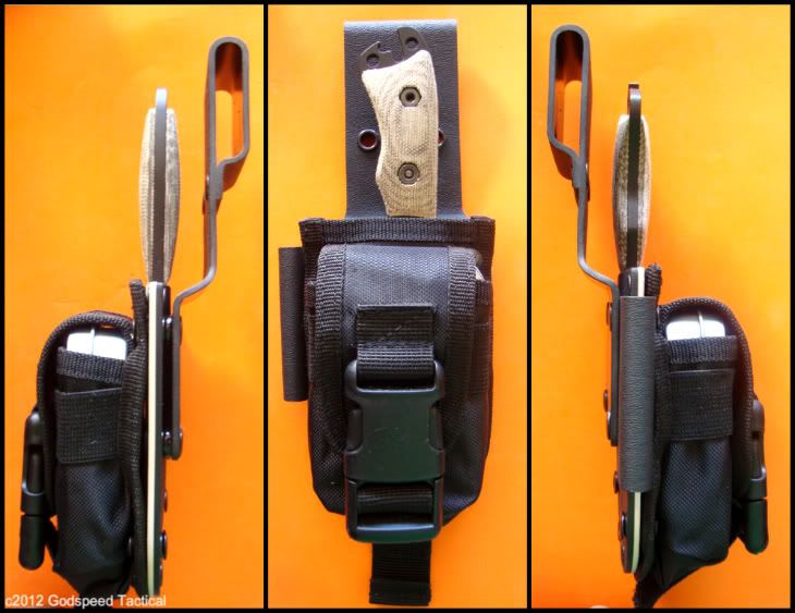

blah, blah, blah.......... here's the pics

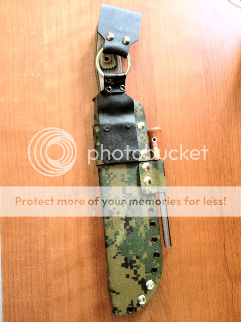

BK9/BK14 Pouch-Sheath combo piggy-backed with accessory pouch and dangler:
Considering the amount of steel in this setup I (and the customer who received it) was really surprised how well it carried, after a minute or two I forgot it was there and my danglers only flex front to back (with your leg movement) there's only a coupld of degrees of outward flex.....though it can be added when molding Kydex to the D-ring. There's also enough relief/drop between the scales and the dangler so that they don't make contact with eachother.
The second "detail knife" pouch-sheath in this combo has it's own sheath even though it's mounted to the larger sheath..... if you decided to you could remove it and use it by itself and leave the larger sheath mounted to a pack too. This shows another advantage to having a "pancake" sheath.... no need to cant rearwards for clearance you can center/secure accessories much better. I could make all of this happen with a "taco" sheath too though.

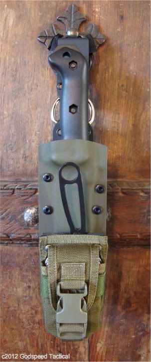

Here's a close-up of the second sheath in that combo with it's own mounting options:

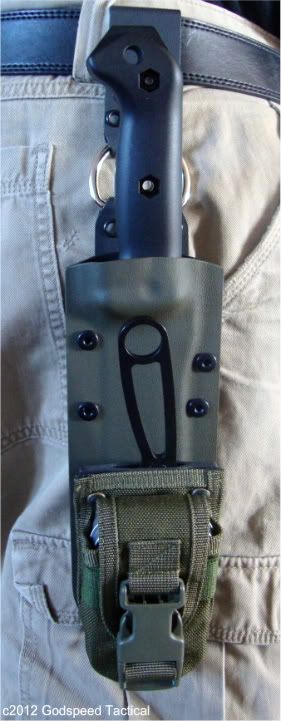

I really like to make/use them with an ESEE-Firekit which leaves more room inside the tin since you've already got Fire, Tinder, Compass/Navigation covered....all on the outside of the sheath. And with a "pancake" sheath you have twice the mounting options though I like to mount them to the rear/blade portion of the sheath anyways.
ESEE-4 w/ESEE-Firekit:
Very similar to the first sheath pictured but with no "piggy-backed" sheath. Still is a "pouch-sheath" though and on a Falcon II (pictured) you can run one of the compression straps between the pouch and sheath (pictured):

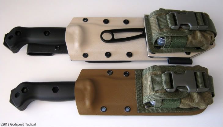

Now for the Mighty BK9! Here's a pic of a BK9 sheath (not pouch-sheath) with an adapter plate for one of my pouch-sheaths BK14:
BK Family Pic:

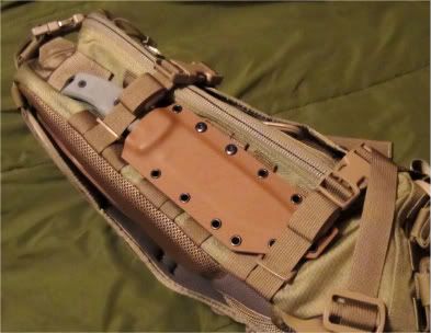

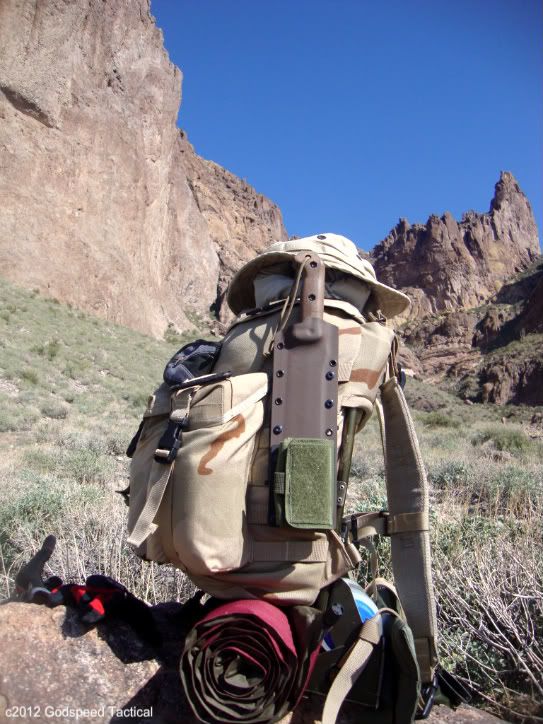

This is a picture of a "quick & dirty" sheath I made for a modded BK9 I'm "borrowing"/reviewing for the BK&T guy's. Pack mounted, it now has a second pouch stacked on top of the one pictured, these pouches are longer than standard "tin" pouches and a SOG multitool & ESEE-Firekit fit in the same pouch. I made this at midnight before an outing we had in the Superstition Wilderness so it was a quickie but I'm real happy with the way it came out and I'm picturing you using something like this for your nine/pack-mounted. I can draw and re-sheath a BK9 one handed while wearing the pack....pretty damn handy and my "detail knife" Izula was mounted to my belt....just in case I get seperated from the pack/9.
Hope this helps. You've got alot of pictures from two different sheath makers now so after this I'm sure you'll have a pretty good idea which direction your heading.
