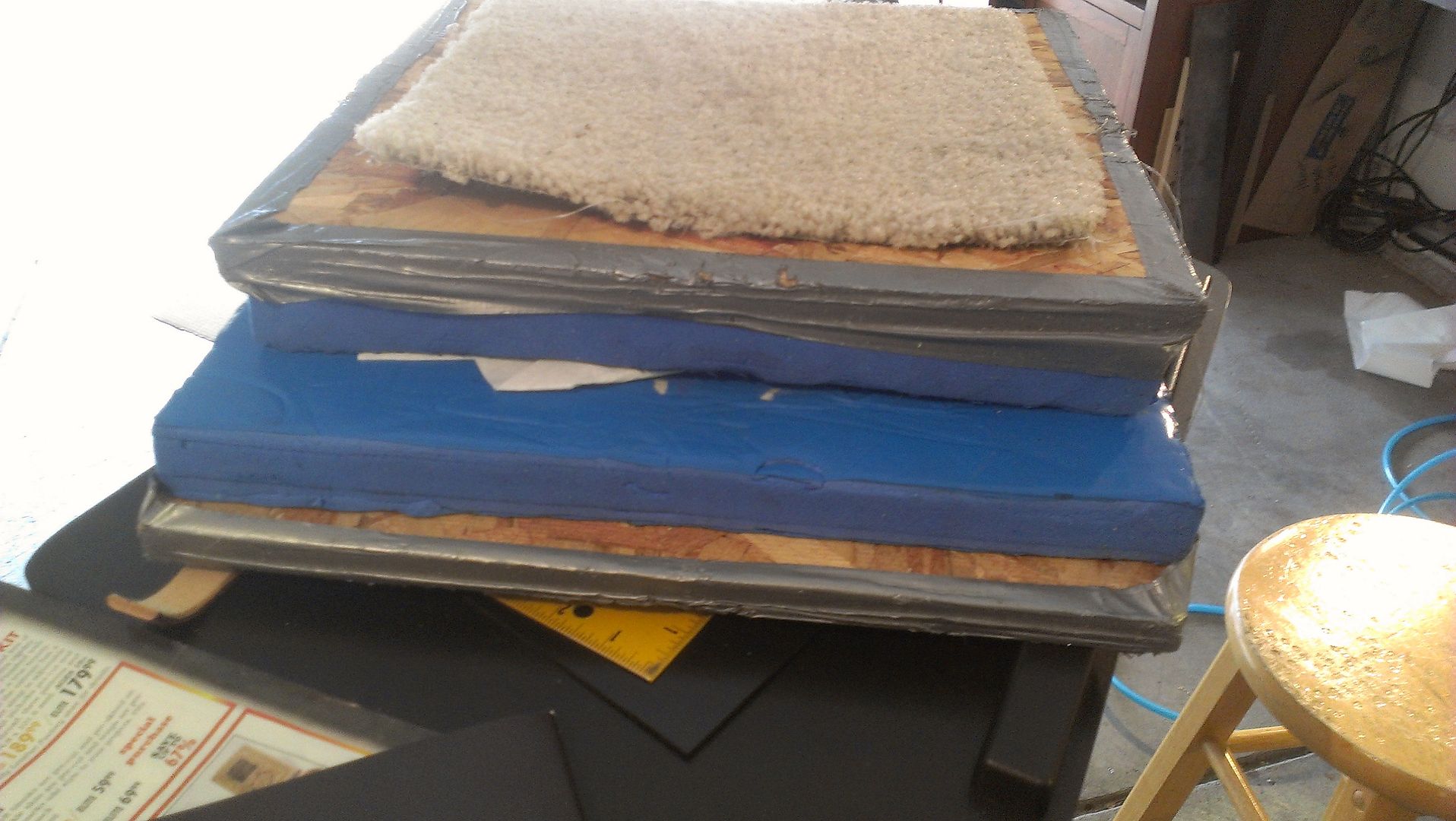

Here is my old press which I used for over a year, same foam for a year too

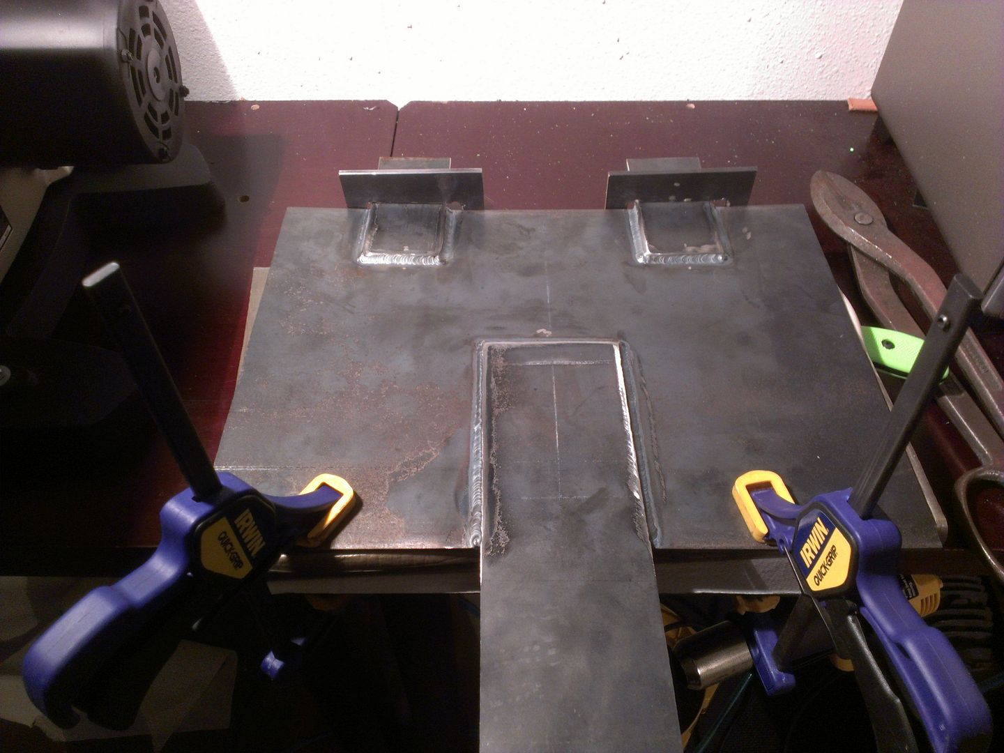

Here is my new press I made and had welded together
