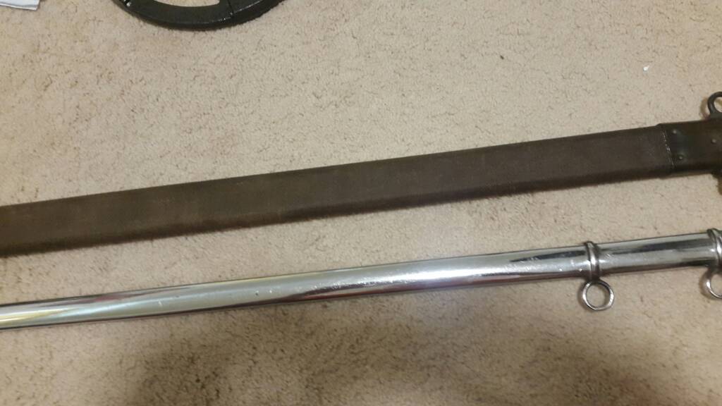

Maybe my Prussian cavalry saber was made in China? The scabbard is made entirely from steel and not wood or leather.
Funny thing, it's much lighter than the Patton saber scabbard from the same time period.
The Patton is made from canvas wrapped wood (with metal throat and tip) which are lighter materials. However them not being as tough as steel one had to use more of it and it ended up much more voluminous and heavy.
They managed to design it in a way that the blade didn't scratch the last 100 years... But just to be careful and not mess up the edge I simply pull it while applying a little bit of pressure towards the spine.
