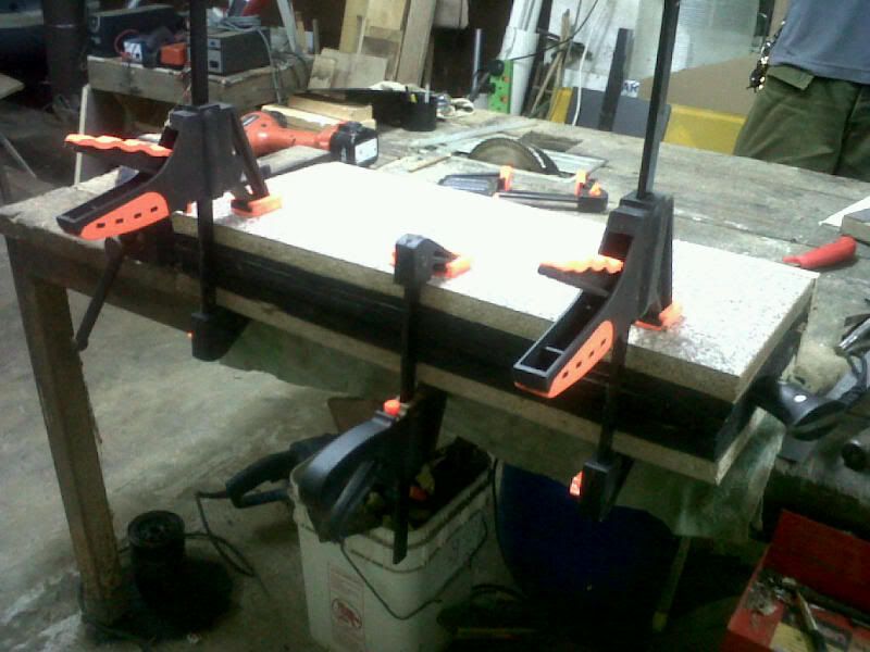

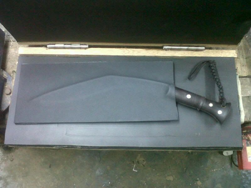

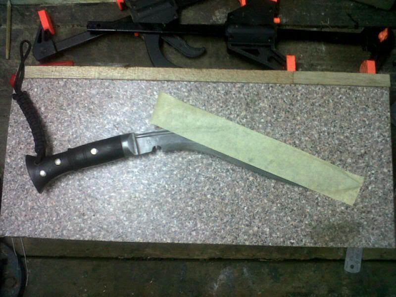

Getting him taped and ready for Balboa whilst the kydex sheets are heated in special microwave at 185 degree C:
Friend's special Penang Kydex Pancake in the making:
Fresh off the oven!

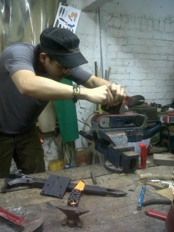

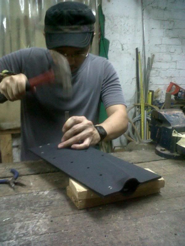

Next is to drill holes and hammer in the eyelets.

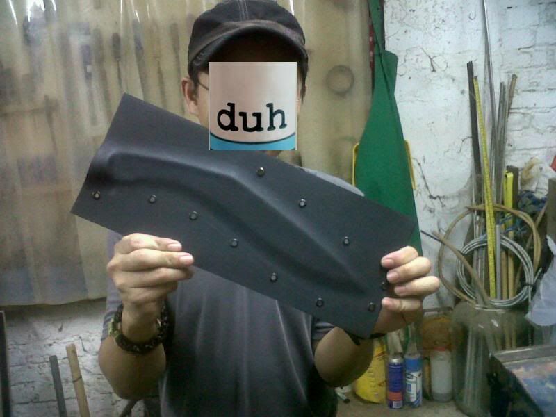

Done and duh..

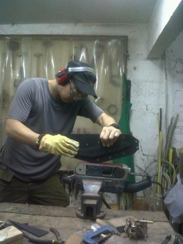

Grindin'

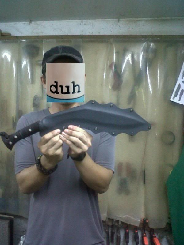

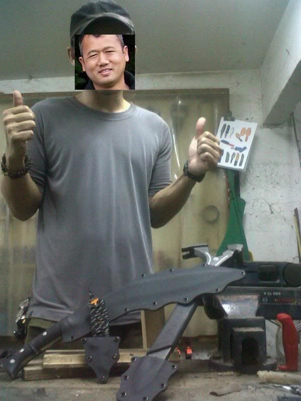

Pretty happy that i've got the skirt ready for Mr.Singh. He wanted it to be curvy.
Made a necker sheath and a protective sleeve for the Dead-On Annihilator tool.
This is Nadir and his Sifu-approved kydex and satisfied glee!
Overall it was a very interesting session and Nadir, my kydex master had been extremely patient and helpful in making everything gravy and sound.
Many thanks to Nadir and his family!
