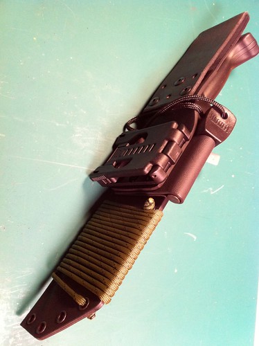

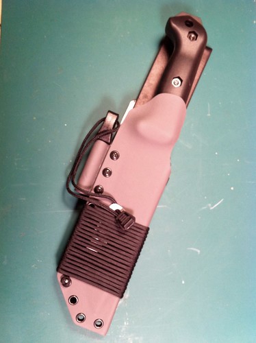

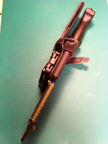

Making a sheath for the BK-7 was a difficult task.. The knife is great, but the sheath it comes with is purely shameful. I usually prefer the aesthetic of the foldover, or 'taco' style sheaths, and the ridged thumb shelf on the BK-7 & BK-9 made it difficult to get good retention with kydex and also make a cool-looking sheath. The experimentation I've seen by others across the inter-webs generally encased the knife in a large kydex 'pocket' to compensate, and I wanted to try to streamline the sheath, to have something that more closely fit the profile of the knife, and accentuated its cool-factor...
After a lot of drawings and a lot more kydex on the floor, I came up with what I think is a good solution. Plus, it's cool-looking. :)
Here are some pics; I'd love to hear your thoughts...

What thickness Kydex did you use for the sheath? I'm not sure if the bigger knives work beter with .093 vs .08........or if you went with .125 :0.

I found that I liked the stiffness of .093 a lot better for this particular sheath; the back end is open to make room for the thumb ramp, and I wouldn't want the knife to slip out of the sheath. That would kinda defeat the purpose :)
