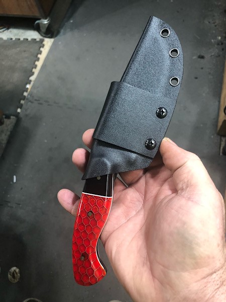

I’m using .080 in both taco and pancake style.
Consistency in retention is what’s getting me. Here are the last two sheathes I made for an example of grommet placement.
D4CC1878-59E4-4EC3-9E5C-B143C4A63081.jpeg 8BF62C71-C7FD-4A47-A4F7-5121D84B113C.jpeg
I believe this is your biggest issue here:
You need a much more detailed impression at the choil/heel area of the blade. Also, the impression at the plunge line looks soft. The Kydex really needs to fold over these contours tightly to get a click.

Try .060 with a little more heat and a lot more pressure

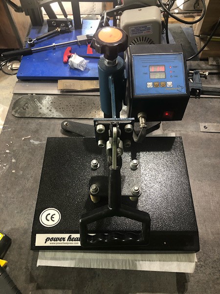

I use a T-Shirt press to heat my kydex. More uniform heating and very controllable. They can be found very cheaply on Facebook Marketplace or Craig's List.
That rivet at the choil is to high, move it down give the kydex room to flex when inserting and taking the knife out.
I prefer .060 kydex. Be sure to have the blade taped when you set the rivets. I leave it in the press a long time to insure the best impression.

Big thank you to everyone in this thread for the advice. Newest sheathe is perfect.
added some heat, but the biggest change was the amount of clamping pressure and more attention to rivet placement. Thanks again all!
