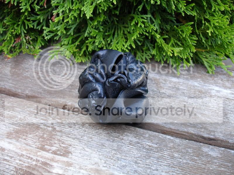

I haven't seen any books. I found a few basic tutorials online, Bought a few chunks of Kydex, and gave it a whirl. Here's how my first project turned out:
That was supposed to be a sheath for my WSK.
The Kydex sheath making adventure has been trial and error for me. And the 'black ball' has really been the only error (cause by too much heat). After that episode, I learned to STAY and WATCH the kydex. I also start the oven a little below the opitmal temp, and then bring te temp up after the kydex piece has been in there a few minutes.

Thanks, that pic was slow to load on my PC and I had read your intro before it popped up. It was not what I had expected and gave me a good laugh!:D :D

That is typical Oven Baked Kydex!!!
That's why I don't use an oven any more...
When you cook in an oven, can can do NOTHING else..If you pick your nose, you'll forget about the kydex,, and that will be the result...

Hikeeba, thanks for posting that picture. It gives me a good idea of what to expect if I ever try it. :D And like troutfisher, it gave me a good laugh as well. :)

Yep, lessons were learned on that first attempt. These days I use the combination of a toaster oven and a heat gun (not simultaneously) to form my kydex projects. And when the Kydex is in the toaster, I stay right there.
