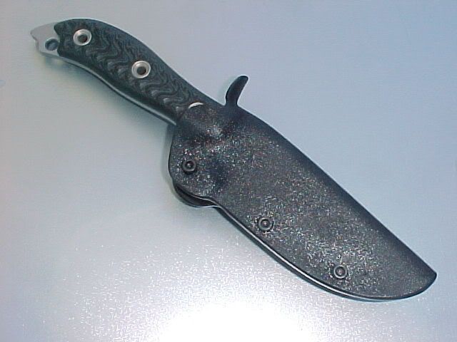

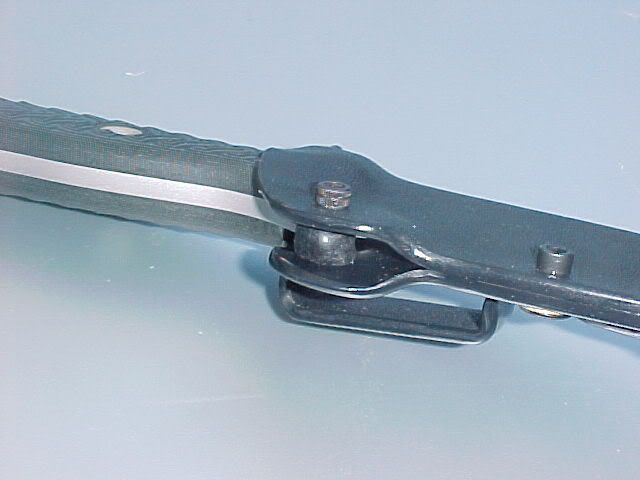

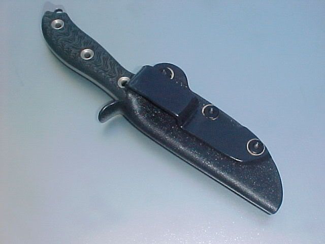

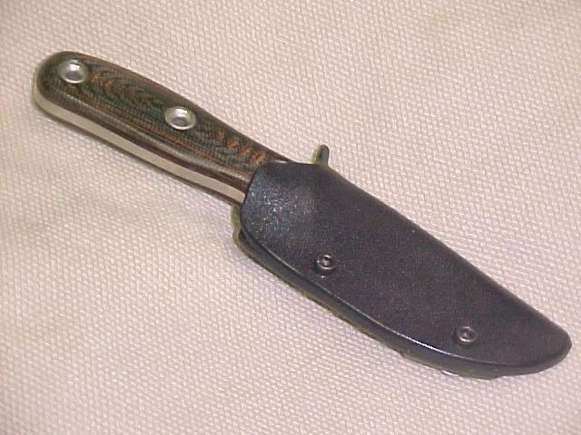

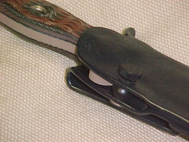

Here are some more pictures of the BATAC sheath. At the bottom, are some pictures that show how to clean out the interior.

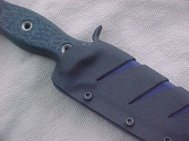

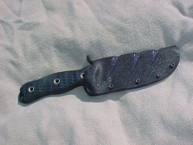

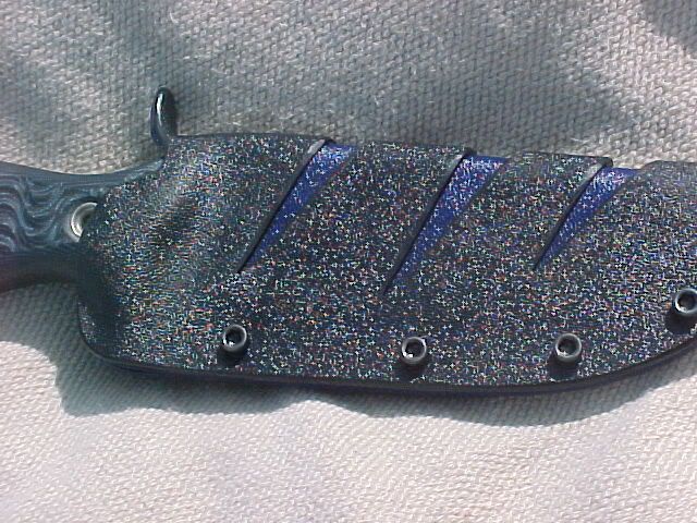

THIS one is a dual layer I call "Ky-Ply" I'll tell you right now, the PIA factor is fairly high, so it costs extra.
Both layers are molded to the knife and are welded together at key places, so it functions like a .120 thick sheath.
This one was made for my personal Blue/Black G-10 Badger. As a result, I did not need to add the tension adjustment. For yours, I would. Just imagine the upper most screw providing the adjustment. Yours would look very close to this one, except yours will be all black.
I feel the need to address the "Ky-Ply" concept. I'm aware that long time Hog David Brown (BuyBrown) came up with a bolt-on flames idea. I learned of it AFTER I came up with my dual layer construction concept several years ago. I've cut out several designs, to include the "tiger claw" (shown) a lightning bolt, Camo pattern (sorta) and yes, even flames. I just want to make clear that I came up with it separate and apart from David Brown. As you can see, my execution differs from his as well.
Now, back to the sheath!
The picture below, I tried to capture a look at the polished edges. That's the sun reflecting off the edge. Where's Lunde when you need him???? :D

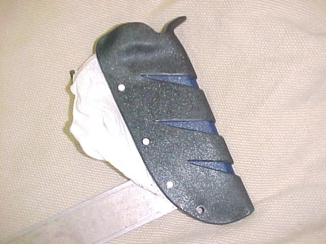

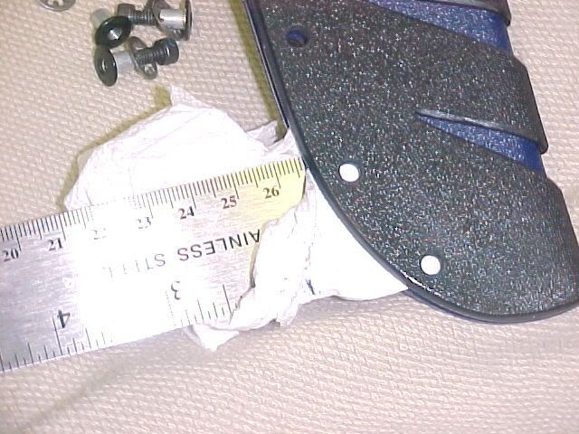

THESE pics show how you clean out the interior of the sheath. Unscrew the hardware, get a clean paper towel and use a ruler (or the knife) and run the towel thru the length of the inside a couple times. Get that grit out and save your finish!!
