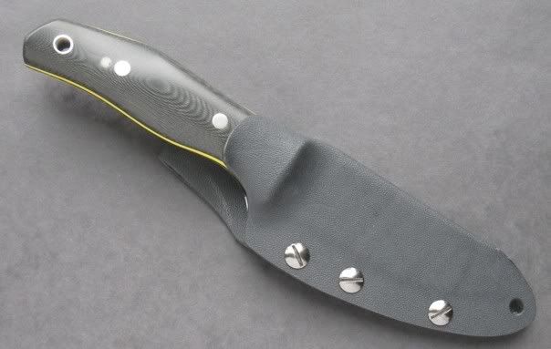

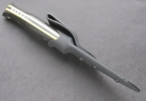

I don't have a great example, and it isn't something I could easily find reference for from others. This is what I mean, let me know if the (old Photobucket) images don't show. The sheath doesn't just fold straight around the spine of the handle, it has been cut into a swooping V so that the material on either side of the handle is a little more of an unsupported tongue. If I took this same sheath, and made a saw cut in the sheath from the point of the V towards the tip of the blade, stopping opposite the first screw fixing, it would approximate what happens with a pancake sheath (not exactly, its a simplified for the example). I have found that I can tune how tight my sheaths are by cutting back the fold, moving the fastener location and trimming around the bottom edge of the finger guard area.
My knives tend to flare a little in handle width at the front of the handle, so I am not reliant only on friction or the grip on the finger guard area. This is a fairly middling example. I have done some where the point of the V is within 1/4" of the front edge of the handle while the tongues reach back another inch.

Thanks for the explanation C_Claycomb. I understand what you meant now, seems like a solid method to use.
It truly feels like there’s a million ways to make a kydex sheath. I’ve personally never seen anyone utilize a cutout like yours, but that’s a great idea. Sheaths (like most other things) seem to come down to a good amount of trial and error, and figuring out what works best for you/your setup. I know I’ve thrown away more sheaths than I’d like to admit... but slowly getting better and that’s what counts :D
