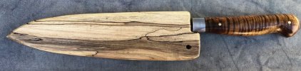

I like making a saya because it looks good. I have a few pieces of spalted maple from my wood pile that I cut a few thin pieces from and make the saya. Takes me about an hour to make one. It's a cool touch too to make the saya from wood that is meaningful to the owner. This maple is from Anvil Island where our family has owned a cabin since the 50s.IMG_1389.jpg
