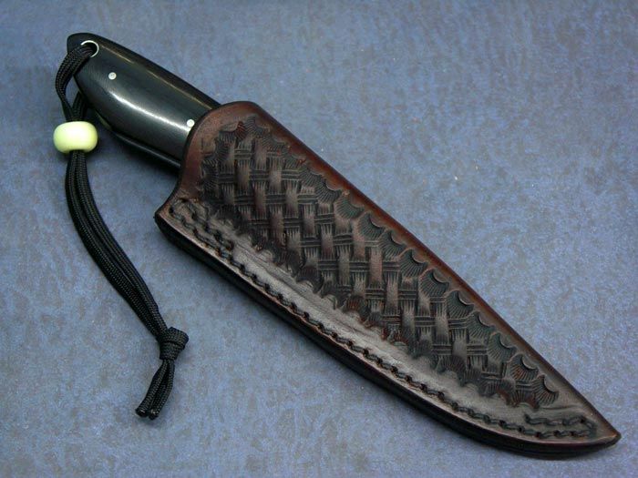

Moving the hamon up into a thicker cross section is hard to do, and looks really nice to my eye. I think creating hamons in western style knives has become its own thing, and comparing them to what is traditional in a Japanese blade is, quite simply, comparing apples to oranges.
If we are going to be technical about material properties, then a fully hardened (tempered martensite) structure is optimal even in very large blade, IMHO. But there are many of us that like the aesthetics of a differentially hardened blade enough that we chase after hamons/transitions anyway. In a blade this size, a hamon is 100% an aesthetic choice.
Nick, we don't have to agree on aesthetics....and we often don't....I'm totally cool with that.
I still love the knives you made me, and I don't collect carbon blades that have hamon anymore because they were giving me fits to maintain.
I like Don, we have a good relationship, and like many here, I'd like to see Kyle walk in the footsteps of his father, and then find his own way.
Making a hamon in more of an Eastern style than a Western Style would be one of the ways to that...and while it wouldn't be in the collection per se, if Kyle made one in this style with the hamon more like I am talking about, it's pretty sure that he would have a sale to a short chubby guy wearing a fedora hat at Blade who would carry and use the snot out of it...with a black sheath of course.;):D

Spot on "The hamon on a knife this size knife is more a visual thing than anything else."
As a Missourian, I believe brown leather is tatical outside of St. Louis and KC :)
The pictures don't show "thin" and thin is great.
Is it light and thin enough for an "in pocket sheath"?
Good job.
Yes, it is less than 1/8" at the thickest point of the spine. Very light! Thanks man!

There's a very good reason to try one STeven's way.
I like the tapered tang but not with carbon steel....I don't ever like exposed carbon tangs....they rust and patina.
The hamon is too high....you can get away with it, but Kyle should make them narrower....it is the "right" way, and he can learn it now, and not make the egregious errors that you and other makers of this generation make.
Needs a black sheath to be tactical.....also maybe a sharpened swedge.
It's a nice knife, and I'm not slamming it at all....but he has opportunities to make it great and make it right....right now.

Kyle: Good to see you with your own mark now, and your consistent quality. You have the most fortunate foundational skills, and I've often seen outstanding knife-making sons/daughters who have propelled themselves beyond, after liftoff. This is your moment.
Who made that nice sheath? (Yes, it looks more appropriate, now.)
Coop
Coop, Kenny Rowe made the sheath.
We buy a handful from him every few months, then makes knives to fit em. Kenny said we are doin it backwards. :cool:
