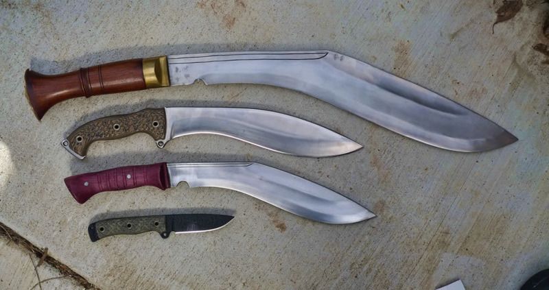

Roughly the same size, but with a variety of different features that make the chopping experience. Next to it is a custom-handled 18" HI Ang khola. People will say "omg the kz's are so huge", well... not really.
Even though, yes, they are big, they are not nearly as thick as most standard Nepalese khukuries:
and with an average size of 18-20" for 'dedicated chopper' models, they are average in their overall dimensions, just with a lot more metal in the handle.

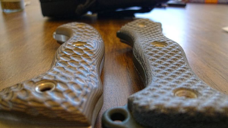

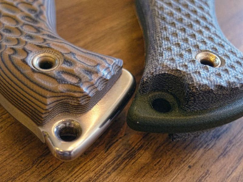

Here are the three handles:
handle shapes:
One important difference, the TTKZ has rounded corners everywhere. The KZII doesn't have "sharp" corners, they are slightly rounded at the edge, but they are much much sharper then the TTKZ. They will bite into your hand if you try to chop with it holding it there.

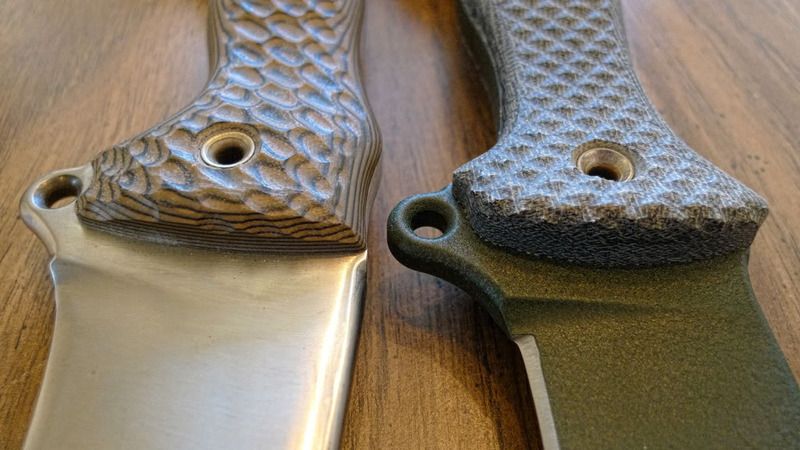

Another example of the sharp corners, this time at the ricasso.

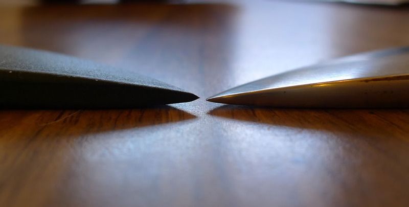

tips
The TTKZ has a finer tip, but the KZII takes longer to get to full thicknss, it has a more acute flatter overal grind even though it's thicker right after the edge.

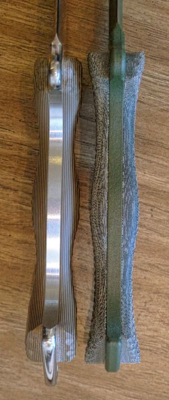

Handle side by side
The KZII allows you to 'roll' the handle in your hand, letting you 'snap' the blade with your wrist, where the TTKZ is locked solid no matter where you have it positioned

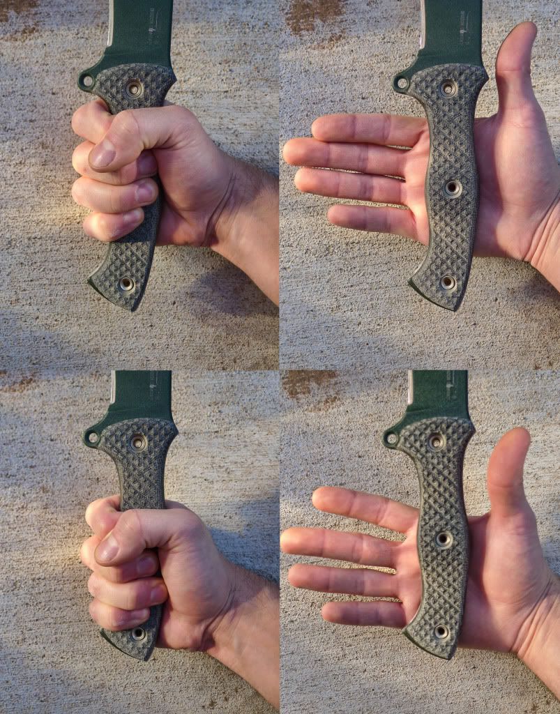

Difference in handle positions. The KZII gives you a better up/down position versatility - but the pommel flare makes it brutal on the wrist/palm. You will be more comfortable holding up in the up position, which requires more muscle endurance because you have to hold it against slipping into the down position. That said, you only get one real grip with the TTKZ, so if your arms going to give out it'll give out without a whole lot of options for moving your grip to a less-strenuous position. Not shown here is a "chocked up" grip where you finger is where the choil would have been - the KZII is better for that grip because it's less tall. The TTKZ is really, really tall at the ricasso which makes it hard to hold in that position.

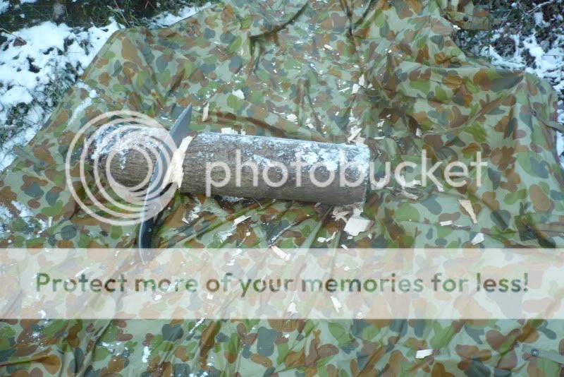

The spine serrations on the Nuclear Zilla are very sharp ... sharp enough to stick the blade into a stump by the spine and use the main edge of the blade for delicate tasks such as field cleaning small bird game ... or you can use this option to assist in heavy battoning by being able to start the task with heavy strikes to the base of a log ... here is a pic to show you what I mean ...
The spine is also very helpful when wanting to use the knife as a machete for clearing thin wispy branches which are hard to get enough "contact" on ... and also for using things like a ferro rod for starting fires ... the serrations are sharp enough to throw a great shower of sparks ...
Sorry, even with the pic, I'm having trouble understanding this. Are you planting the KZ in the bottom log, then hitting the top log with a baton to baton through it using the KZ's main edge?
Yes ... then once started like that and the knife is in the log ... turn it the other way round and baton the base of the log against the stump with the knife inside and it splits down the log easily ...
Yes, you are using both the force of the baton hitting it and the weight of the log to split it, instead of the the force of the baton hitting it plus the (lesser) weight of the knife.

LVC has explained it better as to the advantage of this technique ... using the weight of the stump to assist in splitting it ... works a treat ... :thumbup:
