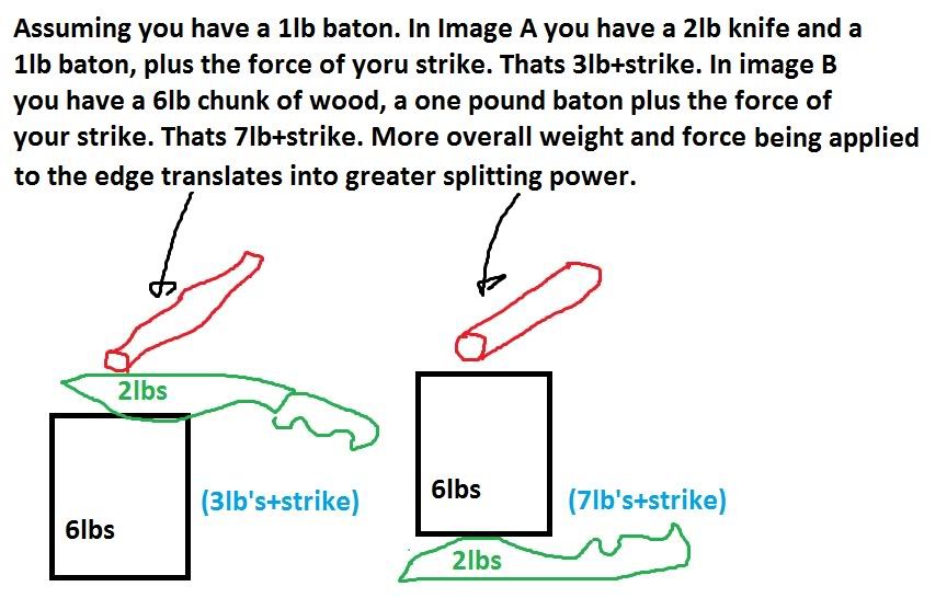

I don't know if this helps or not, but here is a 5 minute mspaint explanation
(using peters images)
weight of knife+baton strike
vs. weight of wood+baton strike
I've never had a nuclear knife large enough to try this, so I can't comment on it's effectiveness, only the idea behind it.
Great explanation LVC ... :thumbup:
For those who want to understand this technique and who have'nt got a nuclear zilla, take a simple axe and when splitting logs hit the axe into the log ( assuming you have a stump or at least another log to hand ) then with the axe embedded turn the axe and log around so the axe is inverted with the log above it and then swing and hit the axe onto the stump so the head of the axe makes contact ... see how easy it is to split the log rather than try to hit the stump with the log and the axe above it.... this latter technique is hard to do right as the base of the log usually hits the stump on an angle ... where as when you hit the head of the axe onto the stump with the log above it is easier for the axe head to bite much deeper into the initial cut and if the grain is properly aligned for the initial hit ... the log usually splits in half straight away ...
