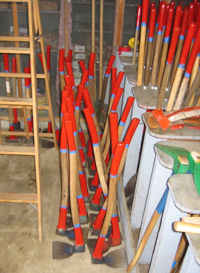

Unless I'm mistaken, Warwood is the last US maker of adzes, aren't they? They're the only ones I've managed to turn up.
I don't know of another adze maker. I see a lot of Warwood grub hoes. They aren't as hard or strong as they used to be. I've seen several come in bent up.
Makes me wonder if people are also less proficient in using them, to boot. A dull blade and brutish swings could cause that. Not surprising that the hardness would have gone down over the years, though.
I don't think it's just newbie damage. Our state trails association has at least dozens of grub hoes, maybe close to 100 in all locales. The only ones I've seen come in bent are new Warwoods. Several of the other guys have commented on noticing the same thing.
There's at least 27 grub hoes in this photo.
Hmmm...have they notified Warwood of this? Should be an easy heat treatment fix, I'd figure.
The new hoes are slightly thinner and I suspect are made out of a lesser alloy. It's clearly a conscious change by Warwood. They don't really have any competitor in this market.
