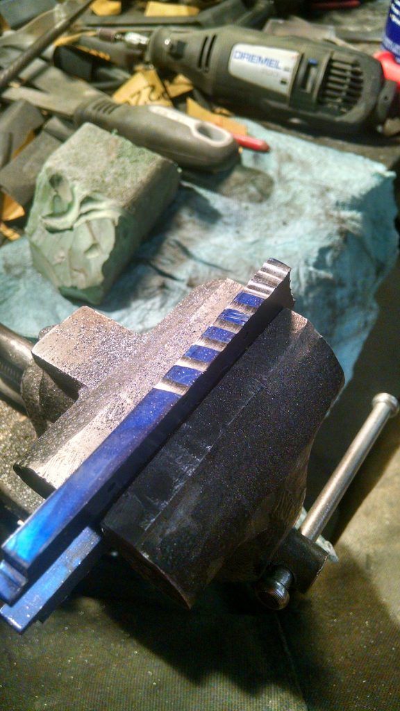

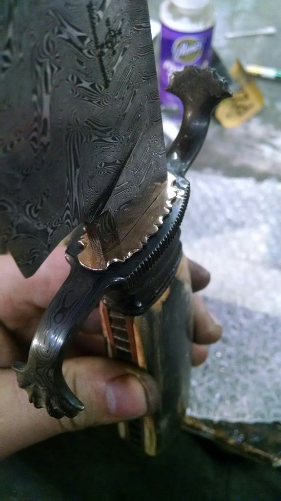

Time for file work on the frame, for this piece I thought it would be better to go simple so that it doesn't start to get too busy.
And after etching and bluing it is on to the dry fit:
And then seeing how everything looks together:

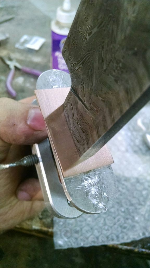

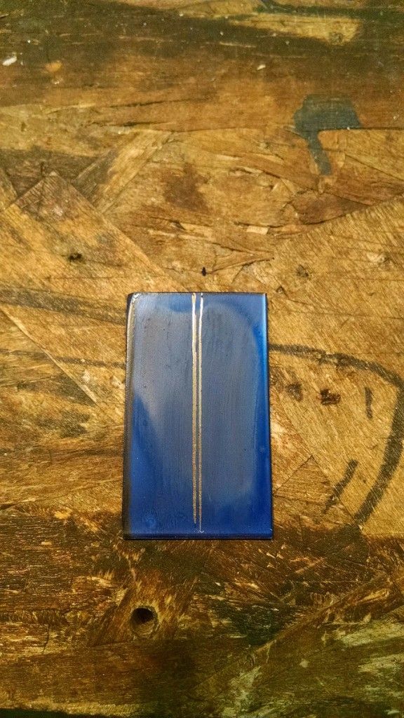

Then after the bronze sheet finally arrived onto the shield, first to find the middle:

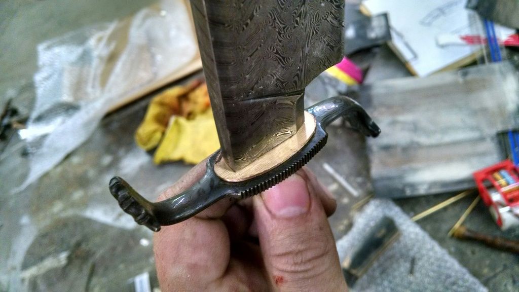

Then slotting and fitting the shield:
Roughing in the oval:
Then onto file work and sanding:

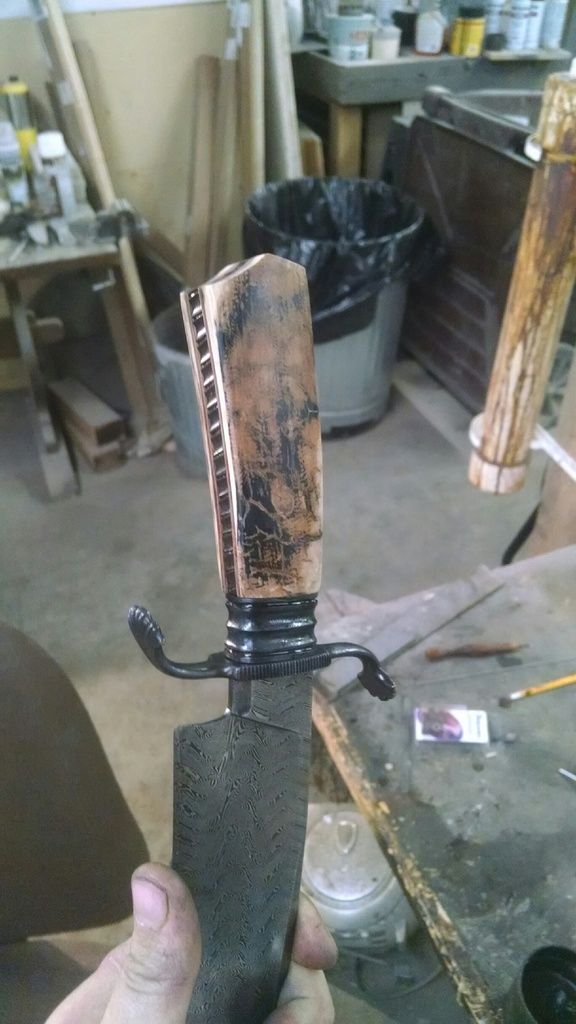

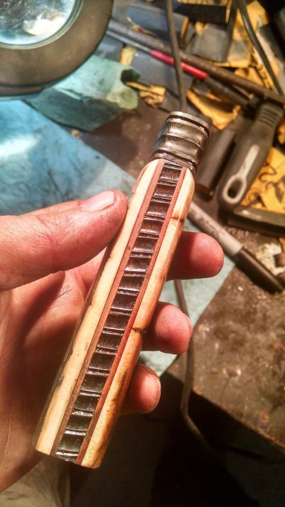

And if all goes well tomorrow it will be pinned together and ready for leather work. Thanks for following along everyone! :)
Well we are finally near the finish line, the knife is now all together (still some minor clean up and the final sharpening to do) but now it is time for the sheath.

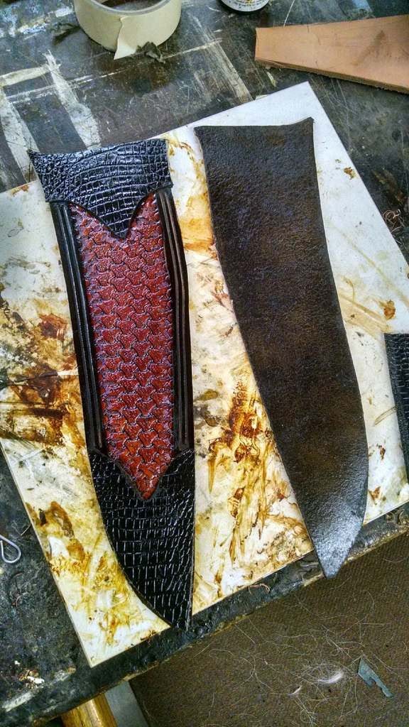

I was able to make some progress on the sheath today getting the primary tooling done and the front/ back are both dyed.

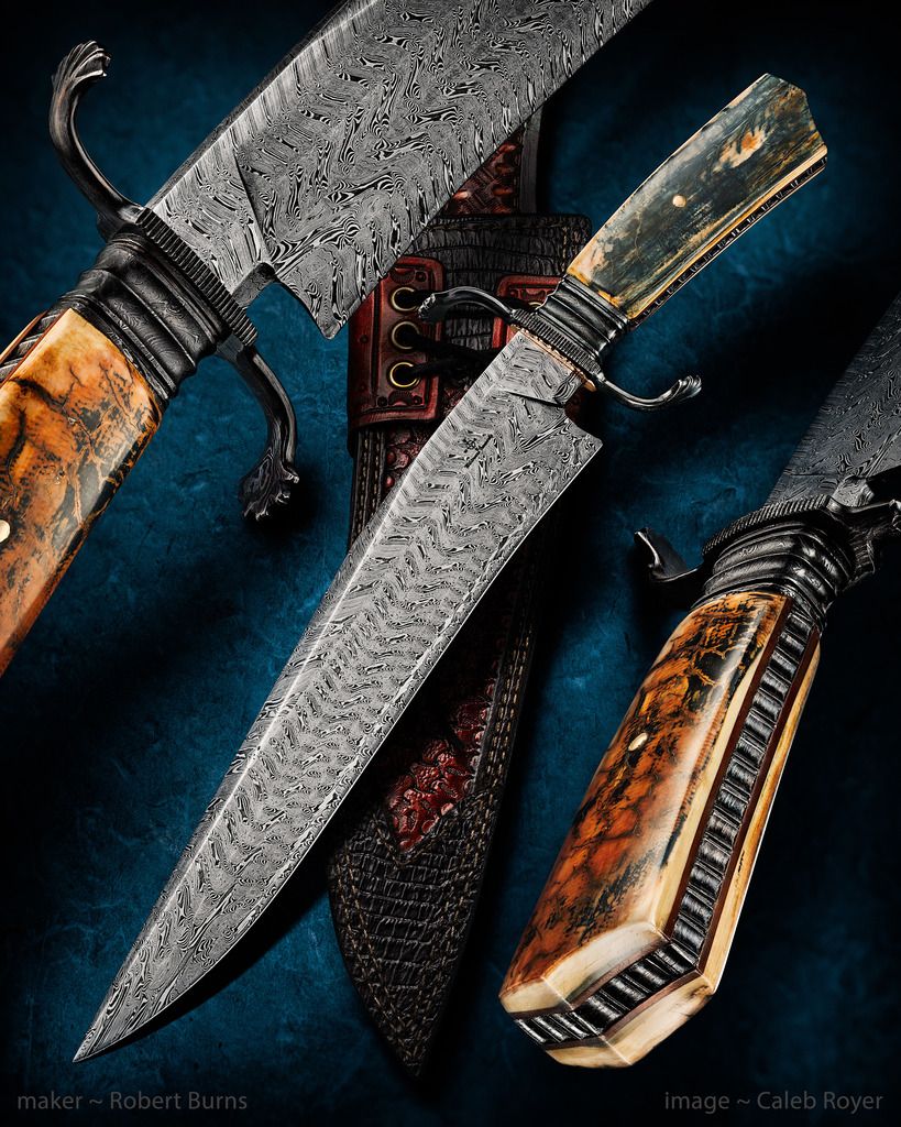

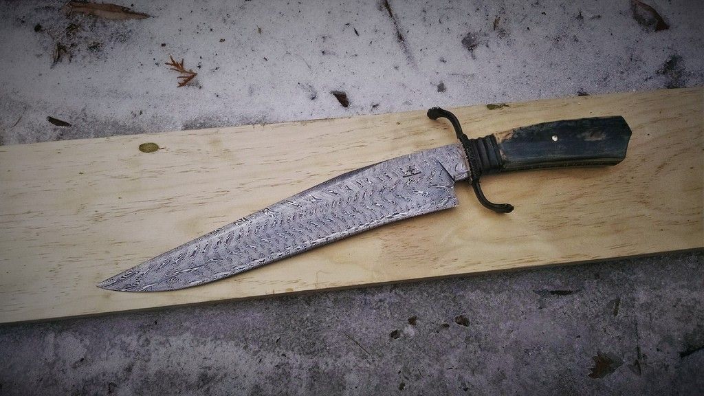

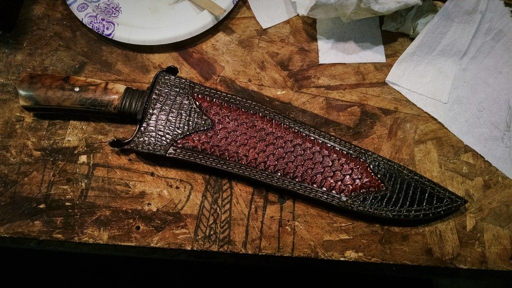

And of course a quick and dirty shot of the knife all together with it's bronze pin. Also once this is fully done I will be sending it off to Caleb Royer to photograph so you won't have to deal with my bad photos anymore. :)

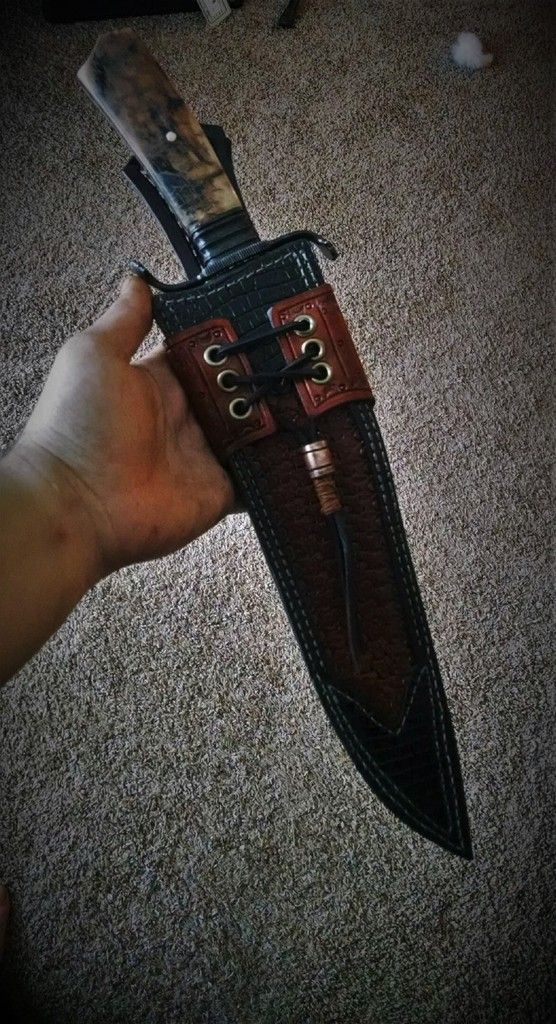

Just a quick small update as this project is nearly done. I only have the bandoleer left to finish today, but so far it is coming along pretty well I think.
Thanks Roger! And finally DONE! Thanks for sticking with me through the build and all of the encouragement along the way. Time to send it off to Caleb to work his magic.
