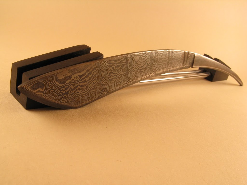

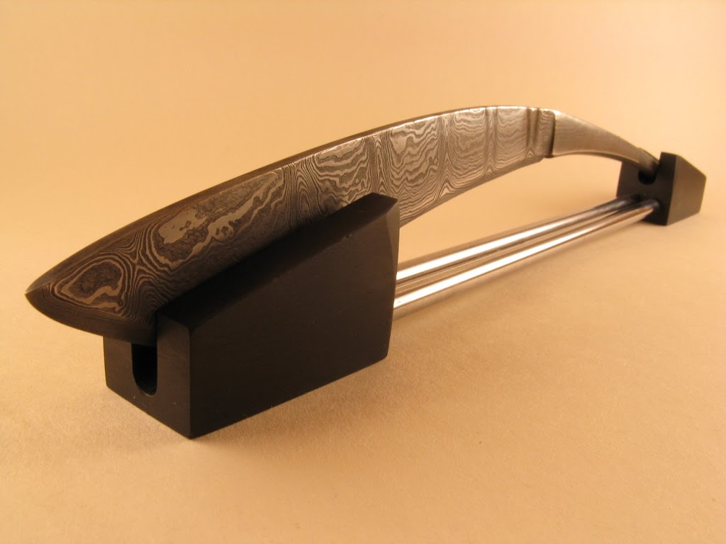

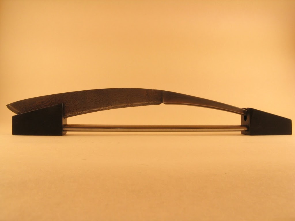

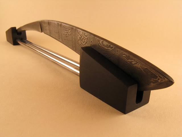

This is my second finished knife (loads still on the slab), a desk-knife-ish-like thing I made for my dad's birthday. I made it from a damascus offcut I got from Rob at Castlekeep on the Isle of Skye when I was touring the Highlands on my motorcycle last year. I ground in slits to half the thickness with an angle grinder and forged the blade flat and into shape, creating the ladderpattern. Filed, sanded, hardened, tempered and etched in battery-acid. The stand was made from ebony which I redneck-milled on my drill press and polished mild-steel roundstock. The pictures were taken in my recently built $10 lightbox. I hope you enjoy the pictures.
This linking to Picasa is not working for me.... see them at http://picasaweb.google.com/rody.koops/Forging#
Cheers Rody
