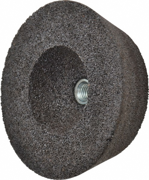

I have seen a couple of guys who have mills use a big face mill to knock down the ridges and then go to the surface grinder for fine tuning. I am stuck using a hard abrasive wheel on a 7 inch angle grinder for the heavy lifting part of grinding of forge/flux scale and knocking down the ridges on damascus. That scale will eat up a wheel fairly quick, but it is cheaper and faster than doing it with ceramic bets.

Using a mill and surface grinder is just too slow. Get a 'snagging wheel' for your angle grinder. I stopped using regular grinding discs many years ago after spending a couple days with Hank Knickmeyer.
Yea, I agree there. A big 7" angle grinder will be faster, maybe not easier but faster. "Snagging wheel" I never thought about that..Work that much faster than a regular rock?

2-3 times faster would be a good guess and last 40 times longer.
I have heard the snagging wheels also called different names. I have the one from grizzly (G7430) but searching snagging wheel does not come up on their site.
Anyway they work much better than discs and seem to last forever. One tip is to release the trigger while you are still in contact with the steel, to slow it down when you plan to stop. Otherwise the inertia keeps the wheel spinning for what seems like forever.
