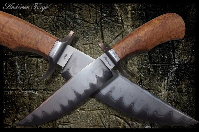

I have seen some folks like Russ Andrews do "double ladder" steel where they have ladder pattern cladding and monosteel core with eh wavy ladder transition line. How do you do that without the core being out of whack? Do you grind the edge down to say a 45 degree short bevel and then just ladder the flat parts? My concerns trying to do it on thin stocker kitchen knives where you idon'thave much to play with.
I haven't forged any knives in this style yet so take this for what it's worth, but I always thought that after the san mai billiet was forged welded and only had the tip forged in, that grooves were then ground into the edge area (or half way up the blade, but becoming shallower in depth) of the outer patterned 'jacket' steel to expose the core steel at the lower portion of the blade bevels. Then the grooves were forged to the surface during the drawing out of the blade. So I'm guessing you need to start out with a 'meaty' san mai billet to cut the grooves into before fully forging the blade to shape so you have enough thickness at the end

If you've ever seen how Claudio Sobral patterns the transition area of his stainless san mai blades before forging the the blade bevels, this will make sense. I'm pretty sure what you are describing is done in pretty much the same manner, but in a ladder pattern as opposed to the random cuts to create the crazy transition 'lines' that Claudio does.

When I do regular ladder, I forge to a slightly foreshortened profile, but do not forge the bevels. I "stock remove" the bevels on all damascus blades. This is particularly effective with random as you expose more layers. The first guy that I saw doing that was Bailey Bradshaw and I was a bit surprised, but it works. I press, but either way , you have to account for the blade blank "stretching" in length. I would think that you probably get a bit more stretch if you cut grooves.
^^ There you have ýour answer.
Etch every now and then while grinding to see where the center is going.

This is the pattern that I was referring to. I am wondering how you could do it on blade that .100 thick at the ricasso and tiers to almost nothing without stretching out the pattern to where it no longer looks good?
I'm no expert, but the few I've done, I hammered the pattern in, then ground it down, rather than grinding grooves, and forging flat.
Tom Lewis explained to me once how he does it, I haven't tried yet, but he would hit the pattern with round dies in his press, then flatten it again in his press, rather than how you would typically do a ladder by grinding grooves or grinding flat.

When I'm going to ladder a san-mai blade, I set the billet up in thirds (aprox) and draw the blade out a bit short of the length I want to finish with.
The ladder is always filed in with round files...i'll wear out 2-3 on a full size bowie. Prior to filing the ladder in, the edge of the blade is ground clean
and etched to expose the thicknesses and centering of the core. If the core is a little off center, some stock can be removed to re-center. Since the thickness
will vary, the file cuts will vary in depth so that the pattern height will be better centered vertically, and near the same on both sides of the blade. Once the
cuts are done, the blade is drawn out to full length, and since the cuts vary in depth, i'll finish the forging near the edge with a hand held hammer.
on a blade with a mono-steel core, the ladder actually is forged in along with the rest of the blade, it just isn't visible. Also, it's best to do a stress relief cycle,
or spherodize, to reduce warp/twist.
I've not done this on a blade thinner than 3/16 or so, but suspect that the same process would work....drawing the blade out to near full length, slightly over thick,
then filing a shallow ladder, and reforging.

Karl, that is my concern with kitchen knives. I have the finer 3/16 inch Uncle Al dies in both straight ladder and chevron and the thinnest that I have ever pressed was a fairly stout 1/4 inch thick pre-form for this 240mm gyuto. I did a fair bit of "stock removal" to get the whole mess "de-ridged" and down to .100 after pressing as you might imagine.
