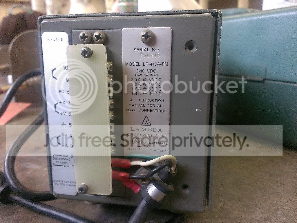

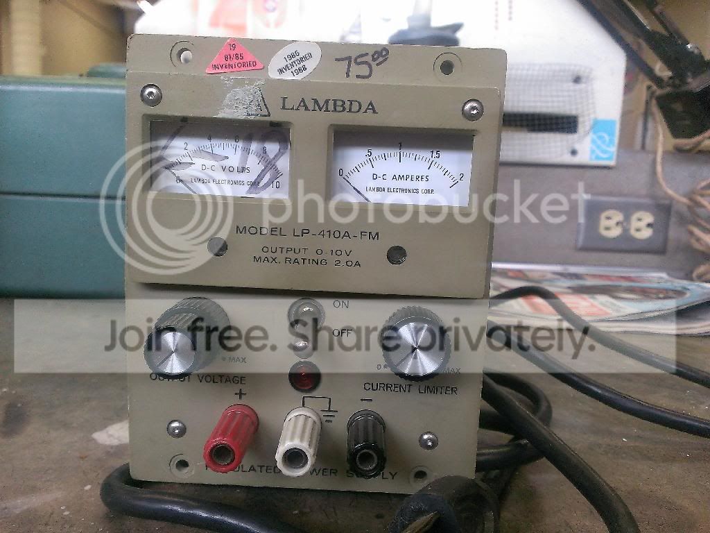

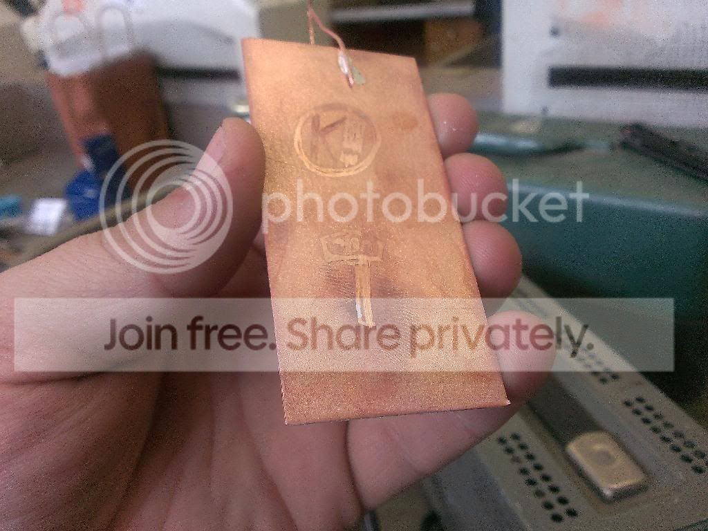

I got this power source at a local surplus store, I did a very mild etch on a copper sheet but I couldn't get the voltage above 2 (according to the face dial, I didn't have a multimeter). Then I noticed the column of pins on the back. I haven't found a manual online for less than $25.

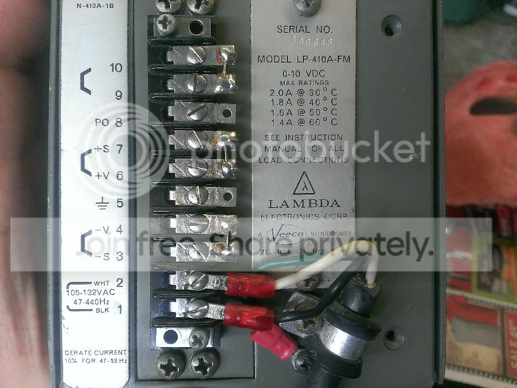

Does anyone know more about these types of power supplies? I think I may need to move the power leads up to the 9/10 pins but I don't want to brick this thing.

What was the current when you were at 0.2 Volts?
Can you get a Voltage indication with the output open-circuit? If so, what will it go to?
If your talking about moving the incoming power leads to 9/10, DON'T DO IT. 9 and 10 are jumped together, thats a dead short.

That is what we used to call, a bench power supply. It is for working on circuits. You can set the max voltage as well as an internal crowbar circuit to limit current. This is useful when testing a board or other circuit and not wanting smoke if there is a problem. The back is for the power input and some other things. Leave it as is.

Thanks guys. After staring at the pins all evening I decided against moving the power leads too. I took a multimeter to it and found that 10v were available when there was no load but as soon as I put a load on it the voltage dropped to 1.3, it put out 2 amps though. Similar to what Tim mentioned.
