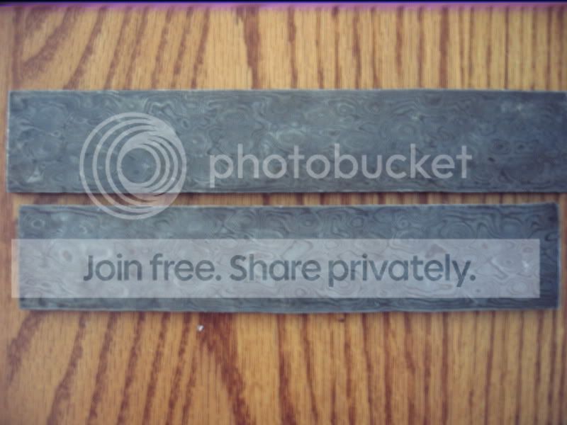

Anywho two pics of whats going out to Pancho and Guitardemon. I will contact you within the next few days with shipping information.
Sorry about the bad photos.
I have another bar of raindrop pattern almost finished but I need more grinding discs first.
-Dan
Thanks Phil, if you want this pattern for your bar I'm more than happy to send a piece to ya. :)

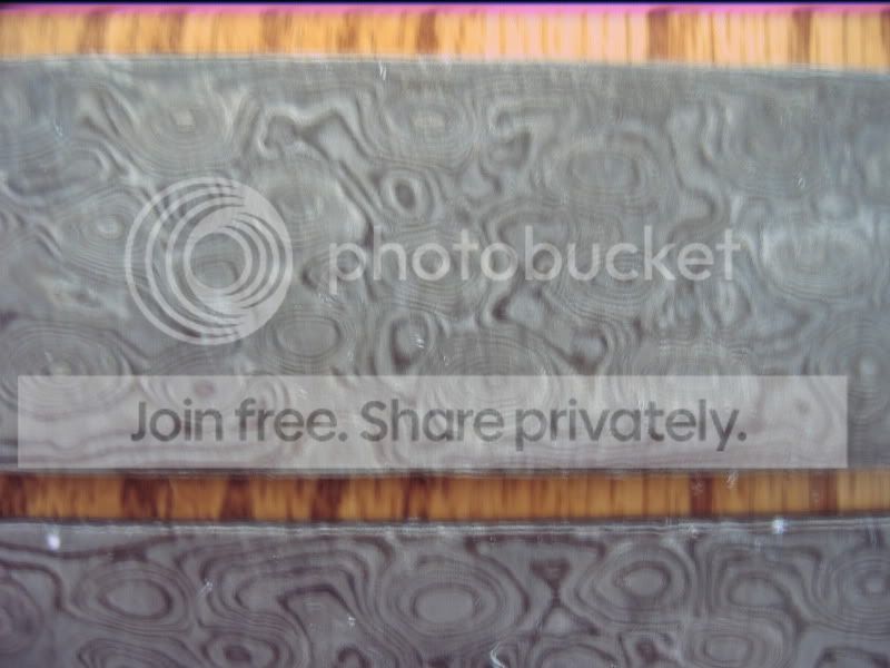

Its a really simple pattern to make Phil. Basically make a billet of 50 to 300 layers (I used 90) and forge it to the width you want and three times the thickness you want. You then drill 1/4" holes 1/3 of the way into the billet. Next you widen the tops of the holes with a larger drill bit (I used 1/2"). Once this is done you forge the bar flat wich forces the lower layers to the surface. Before you draw it into the final size you should take an angle grinder to the areas where the holes were because you will get a thin overlap from the bottoms of the holes being forced up. Once the over lap is taken care of you can forge it into the desired shape and finish as you see fit.
I started this bar with 5 layers of 1/4" 1084 and 4 layers of 1/8 15n20.

So are you drilling from both sides of the bar, or are you folding the drilled side over so it ends up on both sides? I notice the rain drop patterns vary
in width. Are you "counter" drilling with the 1/2" bit varying width? What density are you drilling the hole (how many and how close to each other)?
One more question. What are you doing to remove your scale, how are you sanding your bar and to what grit, and what etching are you doing to get your photos? I'm finding it a lot of work and am not getting very good pattern reveal.

I drill from both sides of the bar. There are patterns where you drill only one side and fold the bar. If I remember correctly this is how pool and eye is made, by drilling and folding multiple times.
I counter drilled about the same for all the holes. I did drill some of the holes to only 1/6 of the depth of the bar though to give it a bit of randomness. As for the density of the holes; I basically just start drilling holes randomly in the billet along the length. I then fill in the gaps with more holes but I try to leave about 1/8" between them so I don't overlap the holes. I'll make another bar and figure out the holes per inch ratio for you. :)
For removing scale and forging pits I use an angle grinder; scale eats though the 36 grit belts on my grinder so fast its not funny. I also prep the billet before the etch with the angle grinder, so its about 24 grit. For etching make sure you clean the bar first. I use acetone and paper towels. For my etching I use 50:50 vinegar and lemon juice for about 4 hours. Because the etching is so slow it really helps to create a great contrast.
