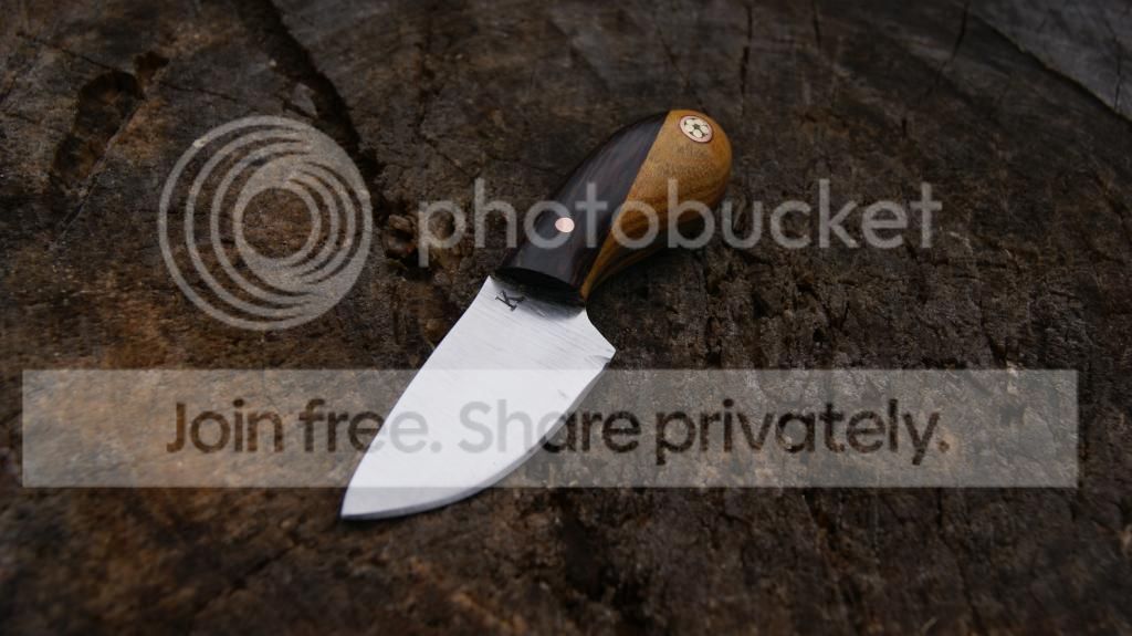

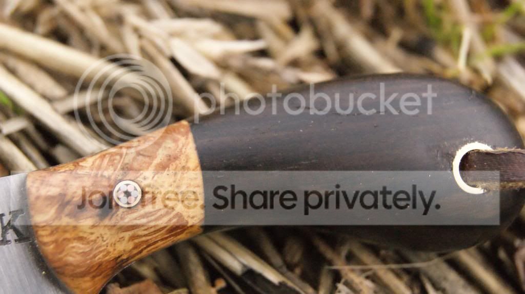

First off, this is one of my first times posting. My name is Joe. I've searched for answers but to no avail.
I laminated too woods, cocobolo and osage orange. I roughed them up and made them flat on a tile with 60 grit. Cleaned it with alcohol. I epoxied them together and let it cure for 24 hours. Epoxied them to my knife and shaped them sanded them yada yada. Well it's been 2 days and I'm noticing there is a slight gap between my laminated woods. I mean it's just enough that I can feel a bur.
My first question is what did I do wrong?
And second, what can I do to fix this? The headaches make it fun but dang...
Two things I can think of... one, you are seeing the glue line, the small admit of glue left over from joining the two. Or they could be separating. You did pick two particularly oily woods to try to join... I'm not sure that you can fix it. You might try hating them up with a steam bath, then popping them with a soft faced hammer. Then sand the epoxy off and try again. Maybe use a harsher degreaser, like acetone or something, then use alcohol to clean up the residue left by the acetone. Re glue and see what happens...
Somebody with more experience might come along with better advice though...
I think they are pulling apart, could I super glue them. Just fill the gap then resand?

If the woods are actually coming apart, I'd speculate the the moisture level in one the other or both is beginning to effect it. The woods may not have been dry, or one has started to swell with moisture. Is it getting worse with time?

I had some old wood I've had for 2 years in the shop, that's the cocobolo and osage. I ripped the osage to 1/8 sanded it down. Alcohol and then epoxied. It was flush snd pretty. I soaked it for 5 minutes in a thin poly then wiped it off, let it dry then buffed it by hand. Let that dry for a good while and repeated then waxed it twice.
Also. I know you can see my marks on my tang. I only have a shotty 1x30 that I only use for handle finishing and it scratches the tang. I try like heck to sand those marks out but I can't without making a ridge because the wood is softer. Any methods? Just order some high grit 1x30 belts for hitting my tang???

Why I still don't think it's a glue line problem is because it was smooth as a babies bottom last night and when I got off work today it has a slight little gap. Which was probably 18 hours? So I'm assuming it's moisture? But why? The environment hasn't changed or anything. Im concerned I'm doing something wrong. I want to know why so I can prevent it. Ya know?
My next thing is getting different hard woods and trying that. My pa and I are going to an exotic lumber shop tomorrow. So. Wish my luck! I guess I really need to figure out how to prevent the shrinkage expansion
Cocobolo takes a long time to season. I have read, and my own experience has agreed, that scales cut from typical turning timber squares will have significantly different moisture contents between the outside and inside of the square. Scales from the inside may shrink compared to those from the outside, if not given time to dry as scales. Drying time may be l...o...n...g, like cut to scales and leave indoors for a year or so.
Also, even in cocobolo, more shrinkage occurs with the rings than across them. Cutting so all shrinkage is perpendicular to the tang' flats will minimise the chance of feeling those gaps. Unfortunately having the rings parallel to the tangs face often shows off the grain best. :rolleyes:
