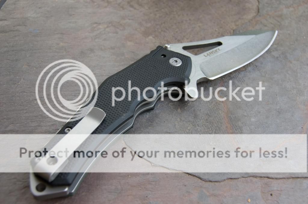

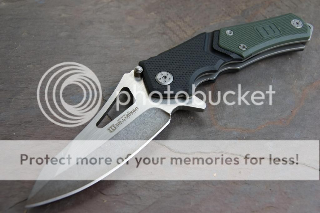

Here is the knife fresh out of the package.

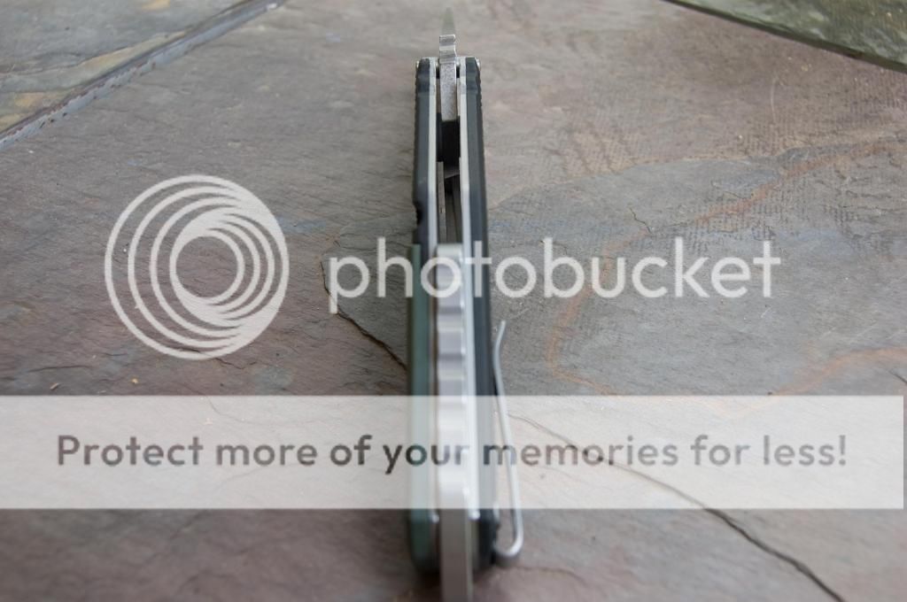

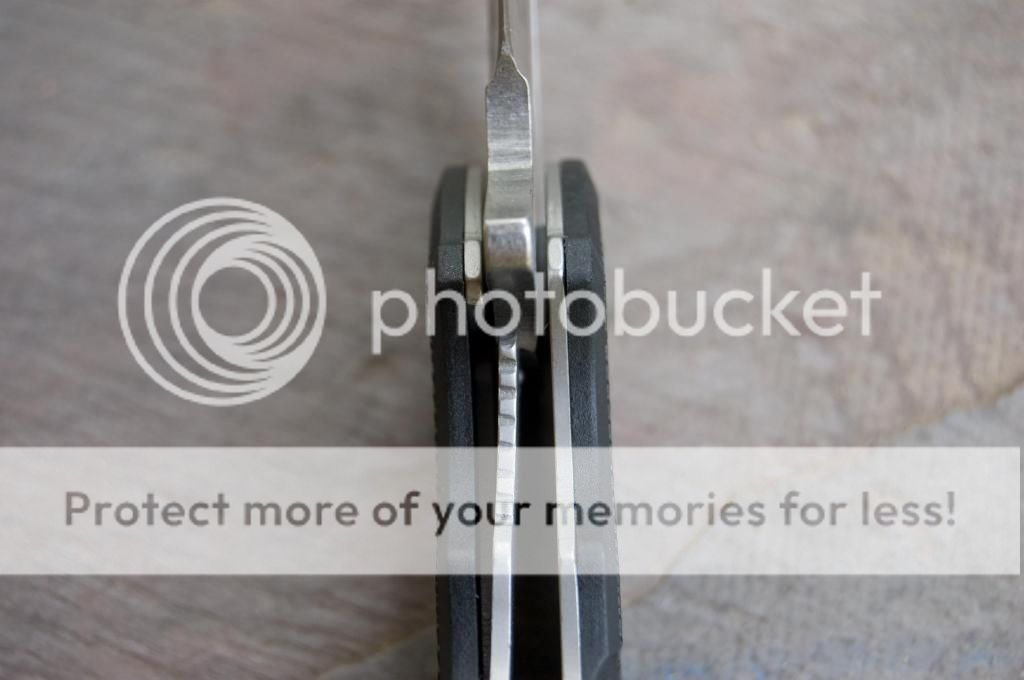

First impressions were that it seemed at least as good as the RAT and Utilitac if not a little on the heavy side. Flipper actually worked without wrist flick. Despite the weight it is easily pocketed and the ergos are very good in the hand. It came shaving sharp. I was unable to move the blade in any direction testing play.

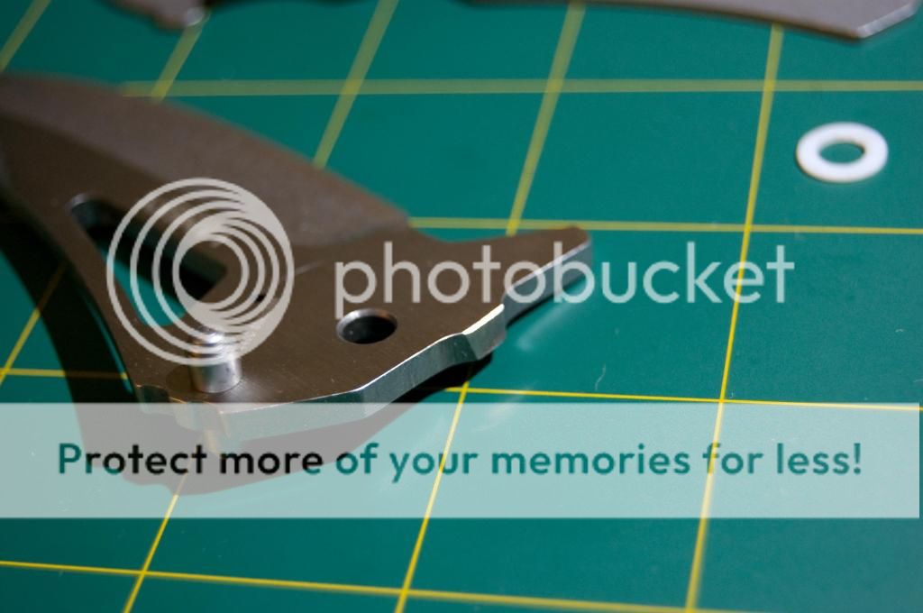

Tang and lock interface. A tad dimunitive IMO but seems to provide enough stability for "normal use" I would imagine. Blade proper is 2oz.

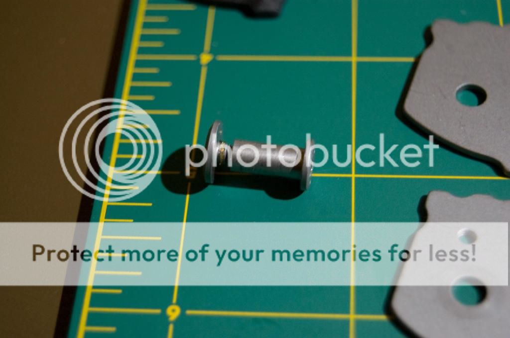

Pivot. That white lock-tite is a real beast to get loose.

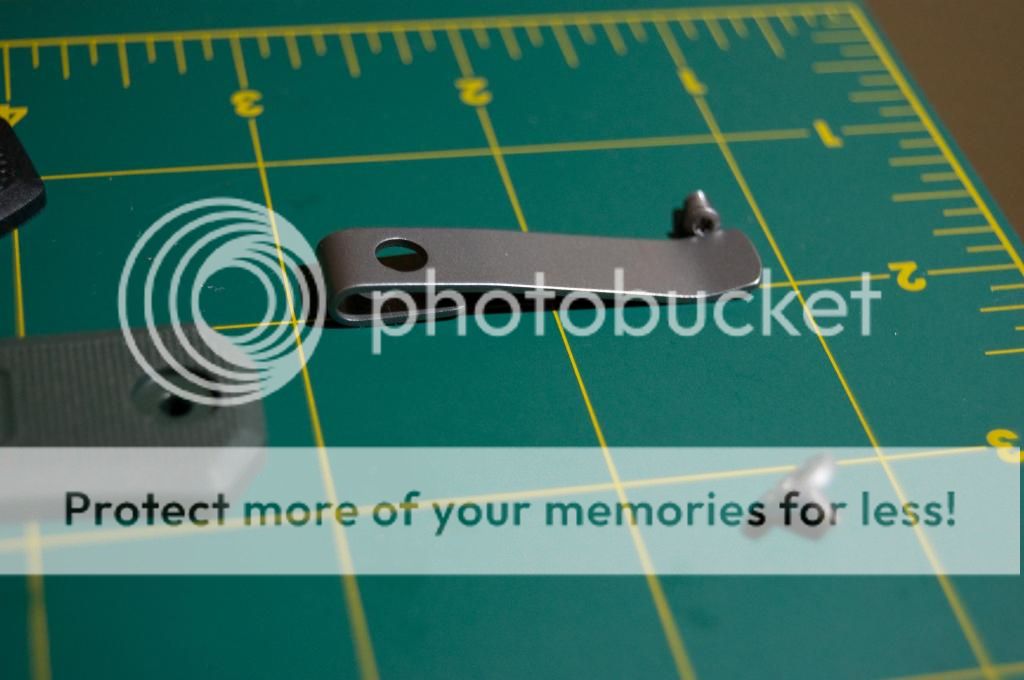

Pocket clip. 2 position. Tip up or down. Pretty deep carry clip.

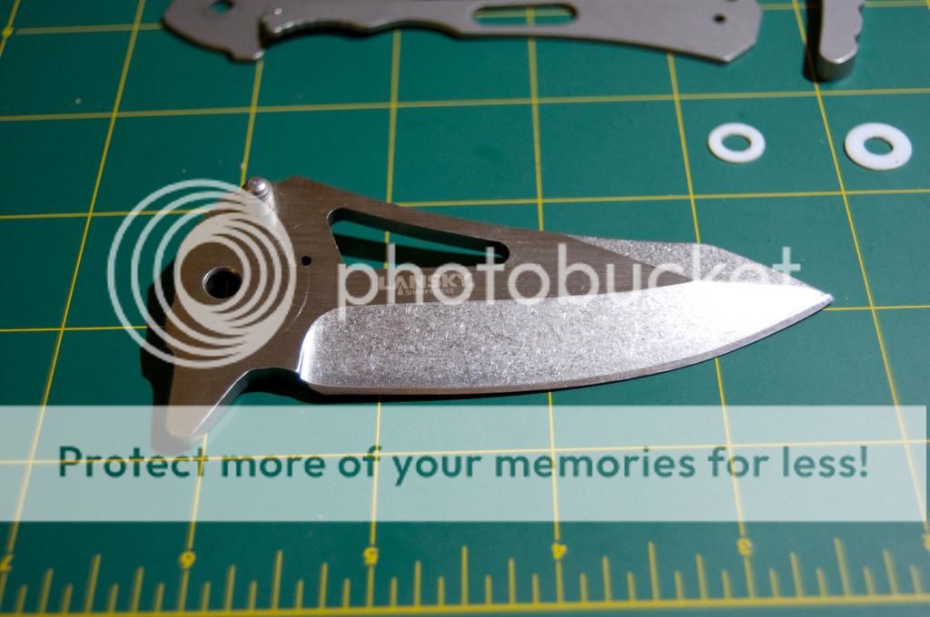

Blade with washers. Note that it comes with nylon washers. Although they perform surprisingly well, I believe bronze/phosphorous washers would be a big complement to the action.

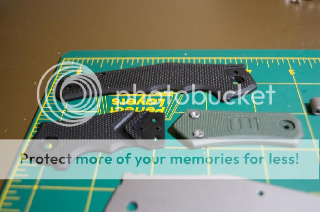

3 piece scales.

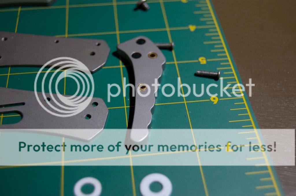

Backspacer with brass bushing inserts. Initially I thought it might be made of aluminum but it appears to be steel. 1.5oz. I believe a G10 or aluminum version would help in the weight department.

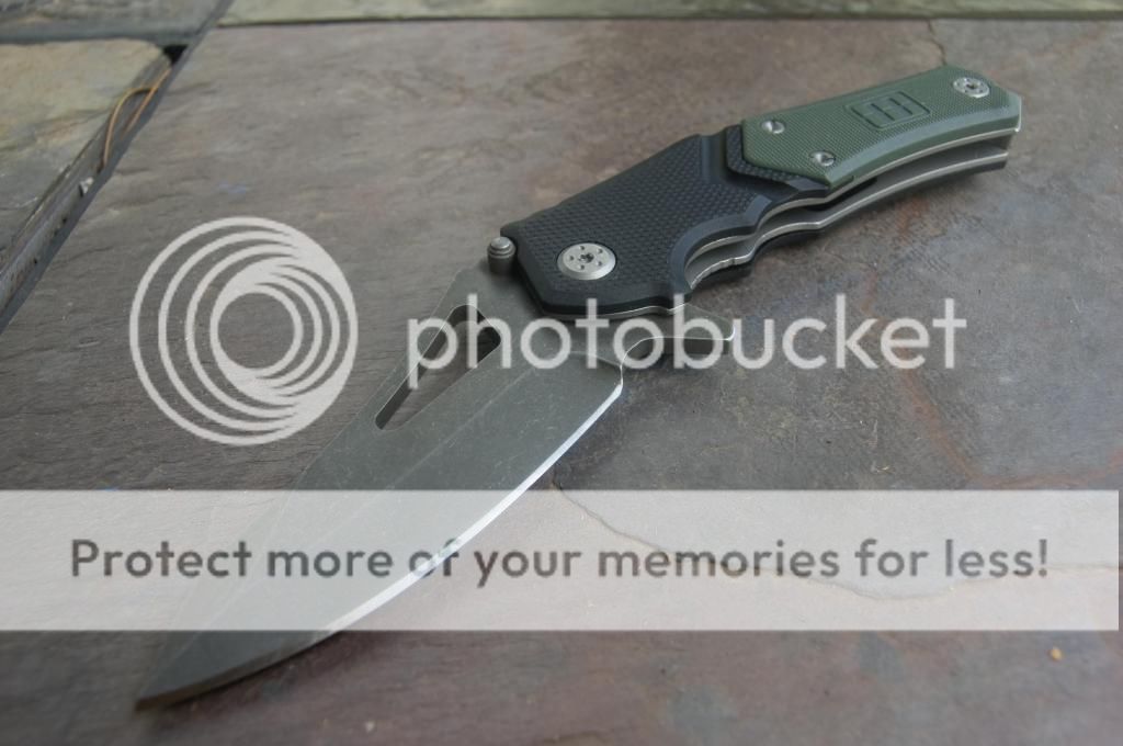

I attempted to drill out the liners but my bits are completely worn out so that will have to wait. I did a quick acid etch/stone-wash and reassembled. Flipper is even smoother and blade sits well centered in the liners.

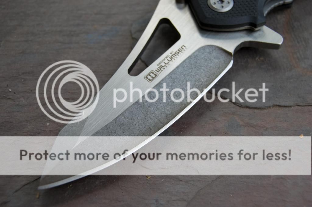

Status post etch, stonewash and wicked edge.

Great review I posted a thread on this knife when I got mine a few months back and it is indeed an amazing bargain. I love the acid stonewashing by the way awesome job!

Sorry to see the increasingly common Chinese white thread locker on this. That stuff is like epoxy or something. I totally destroyed every screw on a Ganzo I bought trying to disassemble it. It had some play in the lock that I wasn't comfy with and wanted to fix. Finally gave up, dulled down the edge, took off the point, and tossed it in the trash. Glad you were successful with this one. Some of these Chinese knives can be real bargains, but that (essentially) permanent thread compound is a deal killer for me at this point. I fortunately haven't encountered it yet on Enlan and a couple other brands.

Well buddy, you know it was only a matter of time before I came to read this. Your pics are awesome and you already know how much I appreciate your acid treatment :thumbup:
I've been considering this one, just to try it out. I really like the blade shape and overall design. The small contact area of the tang and liner concerns me a bit, but then again I wouldn't be doing anything too hard with a $12 knife.

I just received mine... I'm happy, but I had trouble with the clip screw. Mine wouldn't budge and stripped out. Anyone know the screw size? I am going to have to buy a replacement...

Do you know the screw size of the po ket clip screw? I couldn't get mine out, it stripped... need to buy a replacement...
