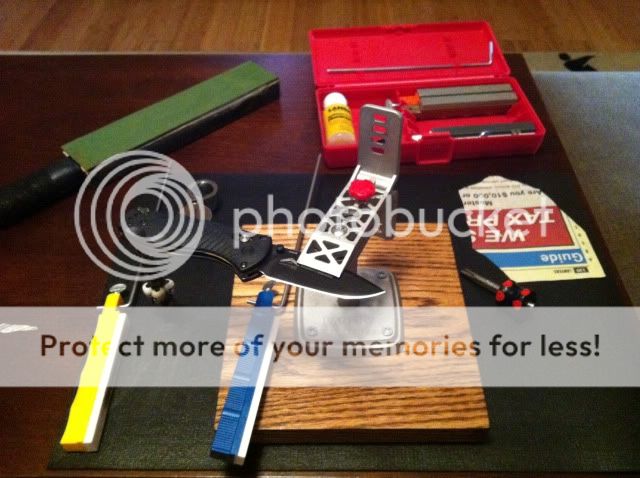

I use the Lansky frequently and I am happy with the results every time.
sharpened just about all of my Kitchen knifes.
My gripes with the system
it's a hassle to un-clamp and move it up the blade, re-clamp.
and continue sharpening on larger knives.
One of the screw in's for the ultra fine stone popped out, might need to epoxy that back in place.
I am happy with mine though.
Here is my Kit.
