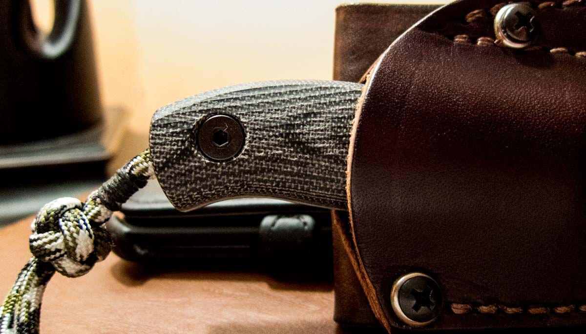

Swo – My edc knife purchased used, but mint, on BF. Same initial mod (by graley, for all I know) w/ a zirc bead/paracord, in kydex. The tumbled steel on fiddleback production knives is exceptional. Even came in handy today at my wife’s baby shower. 35 women wondering how they were going to get a package open … I digress. Thank you to Andy and the three former owners that had a hand in modifying this production Fiddleback Forge runt. : )
Yep looks like the one I did, someone shortened up the lanyard after the first diamond knot but that's the whipping I put on there to help keep it from flopping around :)
