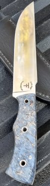

Just wondering how you guys like to install in your tubes. Are they put in straight, or do you flare the ends and countersink the holes? Thank you

I prefer the flared tube ends, they just look better - to me anyway. Most of my lanyard tubes have been straight because I didn't have flaring ability. I just got the stuff together for flaring the tube ends. In fact, been working on that today with practice tubes. By annealing the brass tube before flaring I have less problem with cracks in flared cone.

You don't need dies and presses to flare tubing. It can be done with sharply tapered punches or rounded dapping punches.
cut tubing 1/8" longer than necessary. Place in handle hole with reverse side on anvil. Shape first side. Turn the knife over and do the same thing. It may take a couple of turns for it to tighten up. Then grind/file flush.

I found my old youtube video but it's not great, do this.
-Get scales ready for glueup, do 82 degree countersink on each hole to roughly 1/8" depth. (hole should look right, not massive) 1/4" thin wall seamless tube pin
-Glue up as normal paying extra attention to pin area so no glue squirts out in countersink (clean up with razor or dental pick if some does set up there)
- sand tubes flush with scales at roughly final; thickness to at least 220-400 so the pin looks nice, you can very lightly chamfer the pin now but just touch it
- use flaring jig to flare pins maybe 1/3 way, flip, 1/3 more, flip and finish
- finish scale very carefully
The other option is to superglue the tube in at a near finished stage, make sure it is well centered then flare. This is tricky to get right but how most of them are done in a factory... with or without the superglue.

This is basically what I did the last time I flared a tube and it worked great. I mounted one large center punch in my vise and set one side of the tube in it and used an equal sized center punch to drive into the other side. I flipped back and forth every couple of hammer strikes then tore some thin strips of emery cloth to polish out the tube using a shoe shine motion after I had filed it flush. I did that on a handle that was about 90% complete and had no issues.
