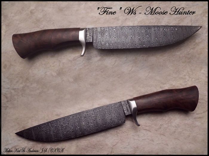

About a year and a 1/2 ago, I made a knife for a customer in Sweden to use for his moose hunts.
That all went well.

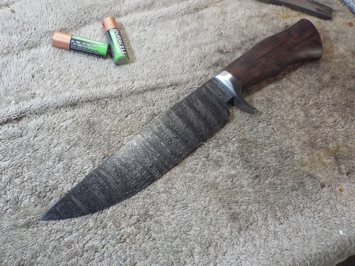

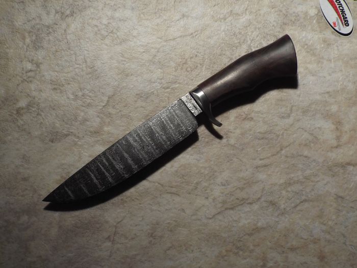

After some lengthy discussions, back and forth, we arrived at what I post today.

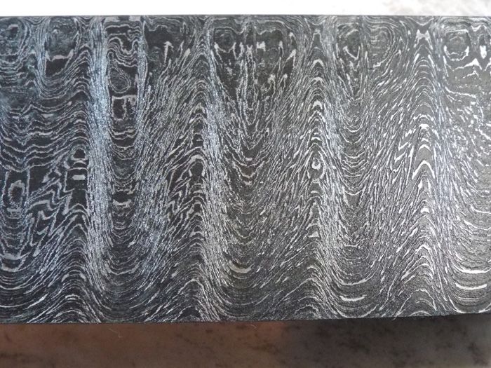

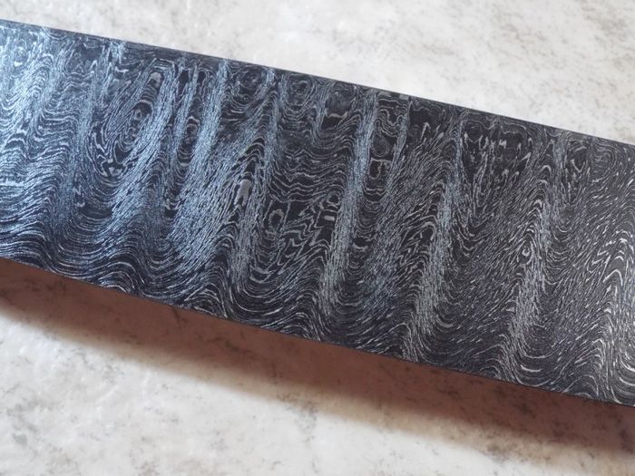

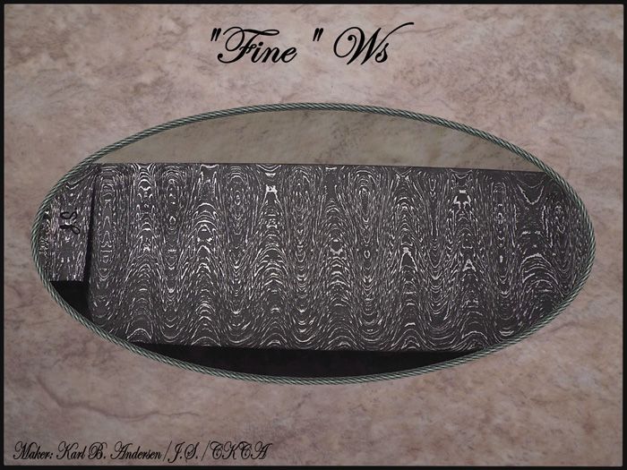

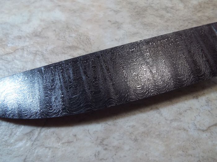

I wanted to do some higher layer count on the initial Ws stacking, so beginning with a 12 layer billet, I quadrupled it to 48 before doing the bias "squish" and then 4x4x4 on the crushed layers. For 64 layers Crushed Ws.
Then I laddered the forged /profiled blade with some new ladder dies I put together with the assistance of my buddy Brian Thie.
Hot blued the 7"+ blade, SS guard and stabilized Feather Walnut in a take-down assembly.
My only regret is that I won't be there to help him get it bloody!!!
