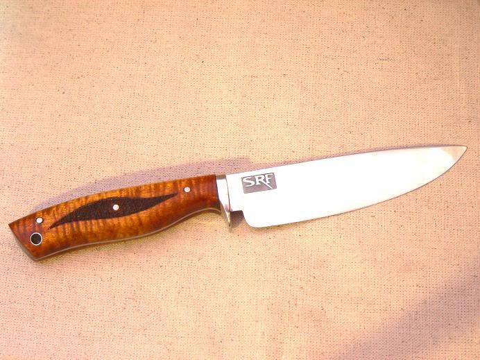

Large Hunting Knife
Jan 14, 2009
75
It may not be large by everyones definition, but it is a good size I think.
Full (slightly tapered) tang
Forged 1095
Hand rubbed 1200 grit finish
Stainless steel finger gaurd
Stainless steel pins

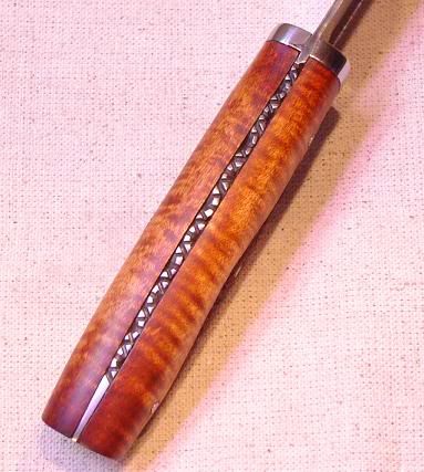

Curly maple scales with stippled inlay
OAL: 10 1/4"
BL: 5 1/2"
A little original file work

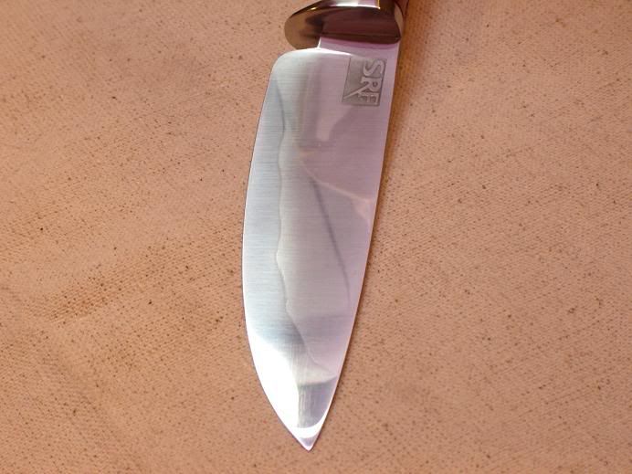

And a sweet Hamon
Thanks for lookin
SRF
It meets my definition of a fantastic lookin' knife. The stiple work really catches the eye and gives the total package a unique look.
Very nice knife.
Handle looks comfortable as is very pleasing to the eye. The stippling definitely adds in my opinion. Fit and finish seem to be top shelf.
I do prefer a longer racasso on a hunter as being able to choke up by placing the forefinger in the racasso/choil area can offer increased leverage when needed.
I would also prefer a more subtle maker's mark, as in my opinion the existing takes much deserved attention away from this beautiful and functional Hunter.

Kevin,
Your comments are much appriciated and duley noted. I have it under good advise to pay attention to comments and critiques from you. I have been told almost verbatum, from 2 MS (Jay Hendrickson and AG Barnes) that I seek advise from on a regular basis, the same thing. The change of makers mark is in the works.
