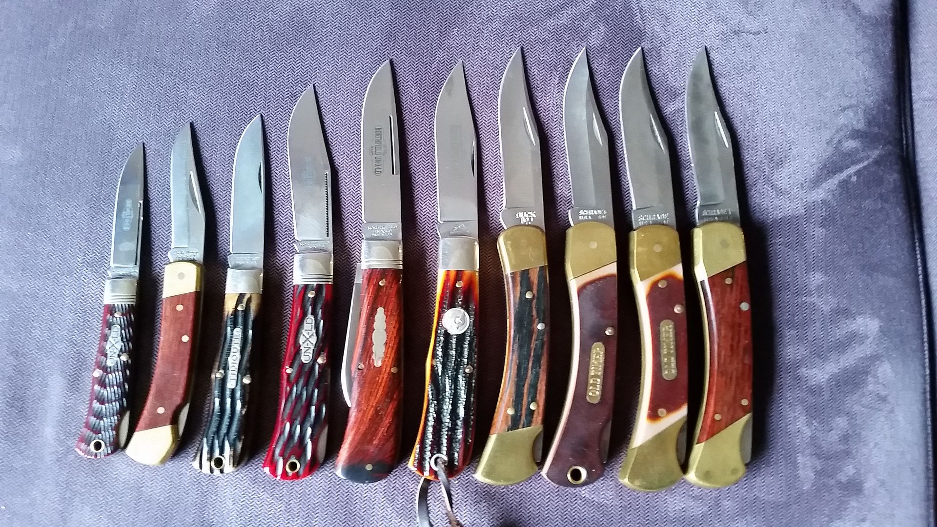

Queen Mountain Man-
D2
big and solid
locking and non locking versions
variety of very beautiful trad scales.
It ticks my boxes:thumbup:
In the pic Left to Right
GEC 83Tascosa Lock back
Schrade LB5
GEC 73
GEC 43
GEC 23
Queen Mountain Man
Buck 110
Schrade 6OT
Schrade 7OT
Schrade LB7
Hope that helps.

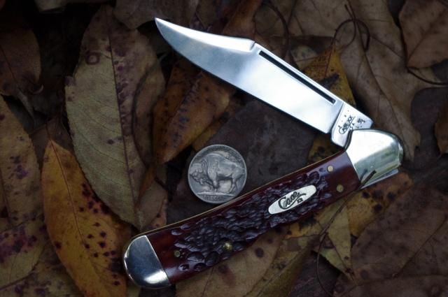

My three favorite large locking traditionals.
Case Large Copperlock

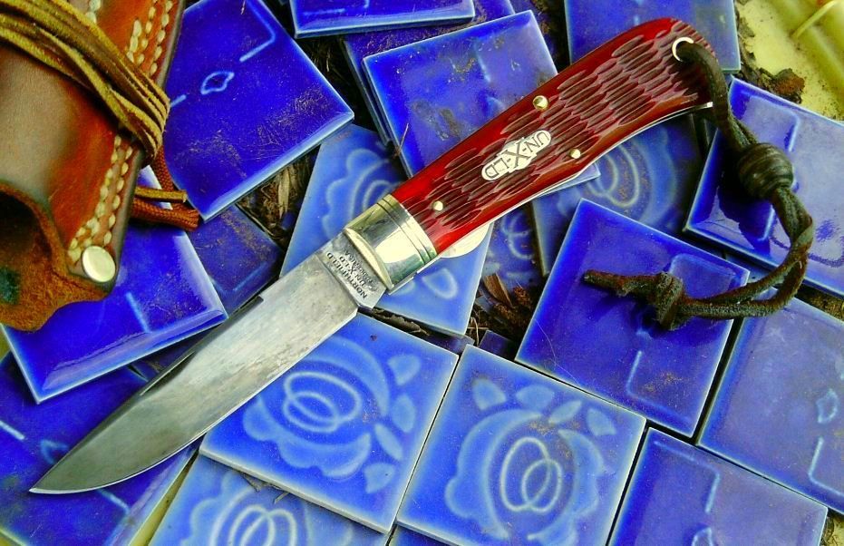

GEC 42 Missouri Trader
GEC 23 Bull Lock
23's
The above 23Liner Lock open (courtesy of Sitflyer). :thumbup:
Whoa Robert! Don't think I've seen the red 23 slippie before! Very nice :thumbup:

I always get a nice warm feeling when I see such a nice patina on a knife :)
