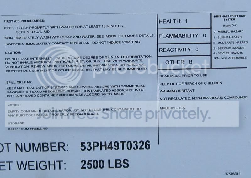

Ok here’s the deal, I have the opportunity to obtain some used containers. They are large, well made, on metal pallets, and in metal cages. The problem is they are used chemical containers that held chemicals used by the waste treatment facility here. They say “not to reuse unless properly reconditioned” and I’d like to know what that entails. I’d like to know if these can be reconditioned to a point where they could be used to store (A) Hopefully potable water, (B) Collect rain water in for the garden, (C) Or last to store fuel in if the need arose.

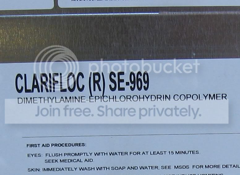

Does anybody have an knowledge of this chemical.
This is the label. I personally thought "a slight hazzard" meant slightly hazzardous...but according to the label it is a slight hazzard but a "non hazzardous" material :confused:

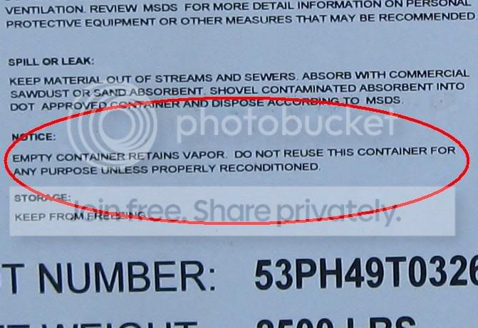

This is the notice on reconditioning.

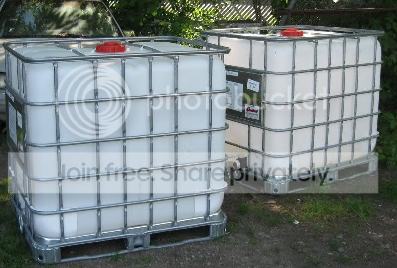

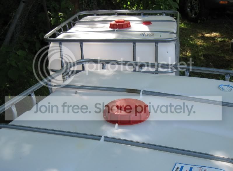

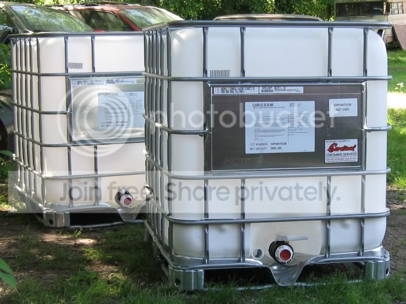

This is the containers themselves and how they are made.

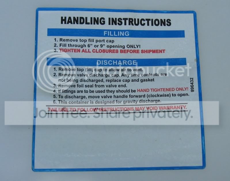

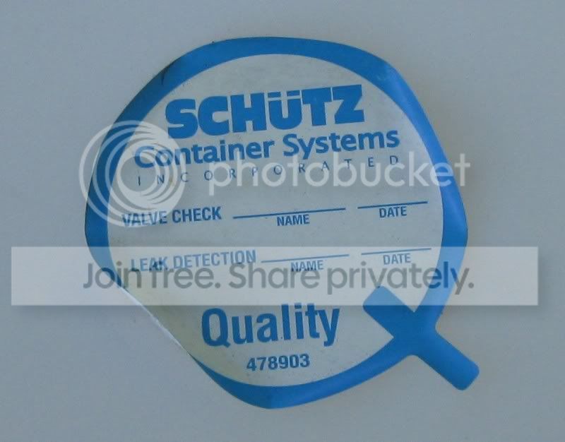

This is the handling instructions and the manufacturer.

I know that , but...it is used in the process of turning waste water into river water which is in turn used for drinking water by others. It says "non hazardous" and that it can be reconditioned...so I am wondering how the reconditioning goes. At least it should be able to be used for collecting rain water for flushing the commode with.
you should be able to get the MSDS info from the waste treatment facility or find it on-line that might give you an idea whether or not you want to use the containers - chris

according to this link http://www.accessdata.fda.gov/scripts/cdrh/cfdocs/cfcfr/CFRSearch.cfm?fr=173.60 that chemical is certified by the fda as a food additive. I dont know if what is in those containers meets all the criteria on that page though. I also see it is used as an algicide though ,so I dont know how good that would be to water plants with. The amount left over after a cleaning would be very minimal though I would assume.

These have to be cleaned by a service that specializes in this. They assess what the material was and they clean these out accordingly. "Clean" does not mean safe to store water in for consumption or for watering your vegetable garden.

I suggest calling the "Container Service" seen on the sticker and ask if you can buy a new one although I don't think they will sell you one unless you have a business use for it. They are between $250 & $400 last I heard. BTW, There is most likely a deposit on those tanks and they are generally shipped back collect to the company that filled them. They appear to be new and have a serial number somewhere on the metal rack or on a tag or label.
This is kind of funny. I have a renter that works at a water treatment plant (potable water, not sewage). He's got a couple of those containers that he uses for rain water collection for his vegetable garden. The exact same kind of container. I believe the copolymer is used as a flocculent. Anyway, it's in your drinking water already.

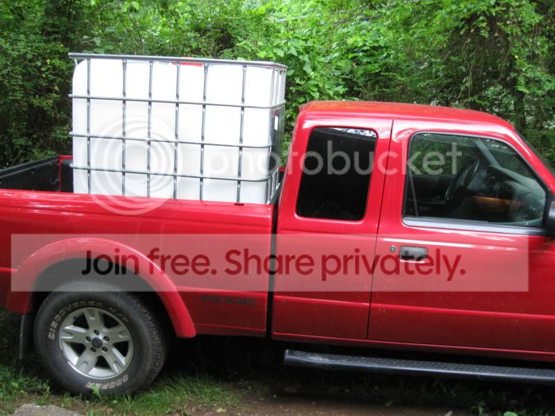

Well, I am thinking at this point that once I get them cleaned out they are simply going to be for the storage of emergency "sanitation" water....I live with three females...but with it being "non-hazardous", and me having a hard time letting anything go to waste, here are a couple of pics that put the size in perspective. If I still had my old F-250 I could haul two at a time but with this truck I decided on only one. I had help loading but none unloading and ya know, these things aren't as light as they look lol.
